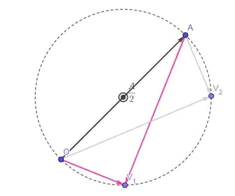

It's Thales' Theorem: If $a/2$ is the center, then $OA$ is a diameter, and $OV \perp AV$ for any $V$ on the circle: enter image description here
Or, to put it differently: For any two distinct points $O, A$, a circle is the locus of points $V$ such that $OV \perp AV$. Then $OA$ is a diameter and $A/2$ the center.

The dot product is the statement of Thales thm in vector form. Vectors $(v,v-a)$ are orthogonal and the locus is a semi-circle containing all right angled triangle vertices. Only a single case is drawn.
