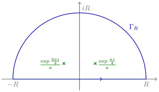

We'll use two standard techniques: Differentiating under the integral sign, and applying the Residue Theorem to an appropriate contour.
Consider the family $I(a)$ of integrals defined by the $$I(a) = \int_{-\infty}^\infty \frac{\log[1 + (a x)^4]\,dx}{1 + x^2}$$ Our integral is $I(1)$.
Differentiating $I(a)$ with respect to $a$ and rearranging gives $$I'(a) = 4 a^3 \int_{-\infty}^\infty \frac{x^4 \,dx}{(1 + a x^4) (1 + x^2)} = \frac{4 a^3}{1 + a^4} \left[\int_{-\infty}^\infty \frac{dx}{1 + x^2} + \int_{-\infty}^{\infty} \frac{x^2 - 1}{1 + a^4 x^4}\,dx\right]$$
The first integral in brackets is $\arctan x \vert_{-\infty}^\infty = \frac\pi2$. To evaluate the second integral, we could use the method of partial fractions to decompose the integral and the Fundamental Theorem of Calculus, but the antiderivative is messy. So we instead apply the Residue Theorem to a standard semicircular contour $\Gamma_R$. The residues of $f(z) := \frac{z^2 - 1}{1 + a^4 z^4}$ inside $\Gamma_R$ (for large enough $R$) are at $\exp \frac{\pi i}4, \exp \frac{3\pi i}4$: \begin{align} \operatorname{Res}\left(f(z), \frac{\exp\frac{\pi i}{4}}{a}\right) &= \frac{1}{2 \sqrt 2 a^3} \left[(1 + a^2) - (1 - a^2) i\right] \\ \operatorname{Res}\left(f(z), \frac{\exp\frac{3\pi i}{4}}{a}\right) &= \frac{1}{2 \sqrt 2 a^3} \left[-(1 + a^2) - (1 - a^2) i\right] \end{align} So, $$\int_{-\infty}^\infty \frac{x^2 - 1}{1 + a^4 x^4} \,dx = 2 \pi i \sum_{z_i} \operatorname{Res}\left(f(z), z_i\right) = \frac{\pi (1 - a^2)}{\sqrt 2 a^3}.$$ enter image description here
Assembling the above ingredients gives $$I'(a) = 2 \pi \frac{\sqrt 2 + 2 a}{1 + \sqrt 2 a + a^2} ,$$ so our integral has value \begin{multline}\require{cancel} I(1) = I(1) - \cancelto{0}{I(0)} = \int_0^1 I'(a) \,da = 2 \pi \int_0^1 \frac{\sqrt 2 + 2 a}{1 + \sqrt 2 a + a^2} \,da \\ = 2 \pi \log(1 + \sqrt 2 a + a^2)\vert_0^1 = \boxed{2 \pi \log(2 + \sqrt 2)} .\end{multline}
