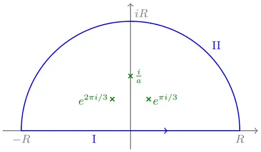

Following Riemann'sPointyNose's suggestion, take $$I(a) := \int_{-\infty}^\infty \frac{\log((a x)^2 + 1)}{x^4 + x^2 + 1} dx,$$ so that the desired integral is $I(1)$. Then, $I(0) = 0$, and differentiating with respect to $a$ gives $$I'(a) = 2 a \int_{-\infty}^\infty \frac{x^2 \,dx}{(a^2 x^2 + 1) (x^4 + x^2 + 1)} ,$$ which is rational. One could decompose the integrand using partial fractions and integrate term-by-term. This computation is straightforward but tedious; it can at least be simplified some by exploiting the evenness of the integrand to reduce to a determination of $3$ coefficients instead of $6$.
Instead, we'll set up and evaluate an appropriate contour integral and apply the Residue Theorem. Denote $g(z) := \frac{2a z^2 \,dz}{(a^2 z^2 + 1) (z^4 + z^2 + 1)}$ and denote by $\Gamma_R$ the contour in the diagram, where $R > \operatorname{max}\left(1, \frac{1}{a}\right)$, and $\textrm{I}$ and $\textrm{II}$ the indicated arcs.
First, $$\lim_{R \to \infty} \int_\textrm{I} g(z) \,dz = 2 a \int_{-\infty}^\infty \frac{x^2 \,dx}{(a^2 x^2 + 1) (x^4 + x^2 + 1)} = I'(a) .$$ Comparing the degrees of the numerator and denominator $g(z)$ gives that $\int_\textrm{II} g(z) \,dz \in O(R^{-3})$; in particular $$\lim_{R \to \infty} \int_\textrm{II} g(z) \,dz = 0 ,$$ so $$I'(a) = \oint_{\Gamma_R} g(z) \,dz .$$ We evaluate the integral with the Residue Theorem. The poles of $g(z)$ inside the contour are at $\frac{i}{a}, e^{\pi i / 3}, e^{2 \pi i / 3}$, and all are simple; the residues of $g$ there are: \begin{align*} \operatorname{Res}\left(g(z); \frac{i}{a}\right) &= \frac{i a^2}{a^4 - a^2 + 1} \\ \operatorname{Res}\left(g(z); e^{\pi i / 3}\right) &= \frac{a}{2(a^4 - a^2 + 1)} \left(-(a^2 - 1) - \frac{1}{\sqrt{3}} (a^2 + 1) i \right)\\ \operatorname{Res}\left(g(z); e^{2 \pi i / 3}\right) &= \frac{a}{2(a^4 - a^2 + 1)} \left(\phantom{-}(a^2 - 1) - \frac{1}{\sqrt{3}} (a^2 + 1) i \right) \end{align*} So, taking the limit as $R \to \infty$ gives $$I'(a) = \oint_{\Gamma_R} g(z) \,dz = 2 \pi i \sum \operatorname{Res}(g(z), z_i) = \frac{2 \pi}{\sqrt{3}} \frac{a}{a^2 + \sqrt{3} a + 1} .$$
Thus, the original integral is \begin{align*} I(1) &= I(0) + \int_0^1 I'(a) \,da\\ &= \frac{2 \pi}{\sqrt{3}} \int_0^1 \frac{a \,da}{a^2 + \sqrt{3} a + 1} \\ &= \left.\frac{\pi}{\sqrt{3}} \log (a^2 + a \sqrt{3} + 1) - 2 \pi \arctan (2 a + \sqrt{3})\right\vert_0^1 \\ &= \boxed{\frac{\pi}{\sqrt{3}} \log(2 + \sqrt{3}) - \frac{\pi^2}{6}} , \end{align*} which agrees with the numerical computation in the question statement. In the last line we used that $\tan \frac{5 \pi}{12} = 2 + \sqrt{3}$, which can be derived, e.g., from the angle sum formula for $\tan$.

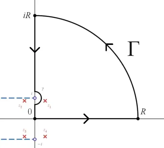

Let $I$ be the original integral. Note that $\displaystyle I=2\int_{0}^{\infty}\frac{\ln\left(1+x^{2}\right)}{1+x^{2}+x^{4}}dx$. Define $f(z) = \displaystyle \frac{\log\left(1+z^{2}\right)}{1+z^{2}+z^{4}}$ where the principal log's argument is defined as $\Im\log{\left(1+z^2\right)} \in (-\pi,\pi]$. Let $C = [0,R] \cup \Gamma \cup [iR,i+ir] \cup \gamma \cup [i-ir,0]$, for sufficiently large $R$ and sufficiently small $r > 0$, and traverse it counterclockwise. A visual is provided below.
Contour C
From the picture above, let each simple pole be $\displaystyle z_{1}=\frac{1}{2}+\frac{i\sqrt{3}}{2}$, $\displaystyle z_{2}=-\frac{1}{2}+\frac{i\sqrt{3}}{2}$, $\displaystyle z_{3}=-\frac{1}{2}-\frac{i\sqrt{3}}{2}$, and $\displaystyle z_{4}=\frac{1}{2}-\frac{i\sqrt{3}}{2}$. By Cauchy's Residue Theorem, we can write $\displaystyle \oint_C f(z)dz$ as
$$ \begin{align} 2\pi i \operatorname{Res}(f(z), z = z_1) =& \text{ } \left(\int_{0}^{R}+\int_{\Gamma}^{ }+\int_{iR}^{i+ir}+\int_{\gamma}^{ }+\int_{i-ir}^{0}\right)f(z)dz \\ \implies \int_0^R f(z)dz =& \text{ } \Re\operatorname{PV}\int_0^{iR}f(z)dz - \Re\int_{\Gamma}f(z)dz - \Re\int_{\gamma}f(z)dz + \Re 2\pi i \operatorname{Res}(f(z), z = z_1) \\ \implies I =& \text{ } 2\lim_{R \to \infty} \Re \operatorname{PV} \int_0^{iR}f(z)dz - 2\lim_{R \to \infty} \Re \int_{\Gamma} f(z)dz - 2\Re\lim_{r \to 0^+}\int_{\gamma} f(z)dz \\ &+ \Re 4\pi i \operatorname{Res}(f(z), z = z_1). \end{align} $$ From left to right, let each expression be $I_1$, $I_2$, $I_3$, and $I_4$, respectively.
To prove $I_2 = 0$, recall if $z \in \Gamma$, then $|z| = R$. The ML-inequality yields
$$ 0 \leq \left|\int_{\Gamma} f(z)dz\right| \leq M\frac{\pi R}{2}. $$ We can get an upper bound $M$ by this:
$$ \left|\frac{\log\left(1+z^{2}\right)}{1+z^{2}+z^{4}}\right|\le\frac{1+\left|z\right|^{2}+\left|\operatorname{arg}\left(1+z^{2}\right)\right|}{\left|z\right|^{4}+\left|z\right|^{2}-1} \leq \frac{1+R^{2}+\pi}{R^{4}+R^{2}-1}:=M. $$
From there, we just use the Squeeze Theorem and eventually conclude that $I_2 = 0$.
To prove $I_3 = 0$, parameterize $z = i + re^{it}$ where $t \in \displaystyle \left[-\frac{\pi}{2},\frac{\pi}{2}\right]$. Then
$$ \begin{align} I_3 &= -2\Re\lim_{r \to 0^+}\int_{-\pi/2}^{\pi/2}f\left(i+re^{it}\right)d\left(i+re^{it}\right) \\ &= -2\Re i\lim_{r \to 0^+} \int_{-\pi/2}^{\pi/2}\frac{r\log\left(1+\left(i+re^{it}\right)^{2}\right)e^{it}}{\left(i+re^{it}\right)^{4}+\left(i+re^{it}\right)^{2}+1}dt \\ &= -2\Re i \int_{-\pi/2}^{\pi/2} e^{it}\lim_{r \to 0^+}\frac{1}{\left(i+re^{it}\right)^{4}+\left(i+re^{it}\right)^{2}+1}\lim_{r \to 0^+}\left(r\log\left(2ire^{it}\right)-\frac{ir^{2}e^{it}}{2}+ O\left(r^{3}\right)\right) \\ &= -2\Re i \int_{-\pi/2}^{\pi/2}\frac{e^{it}}{i^{4}+i^{2}+1}\left(0-0+O\left(0\right)\right)dt \\ &= 0. \\ \end{align} $$
Here is the calculation of $I_4$:
$$ \Re 4\pi i \operatorname{Res}\left(\frac{\log\left(1+z^{2}\right)}{1+z^{2}+z^{4}}, z = z_1\right) = 4\pi \Re i \lim_{z \to z_1}\frac{\left(z-z_{1}\right)\log\left(1+z^{2}\right)}{\left(z-z_{1}\right)\left(z-z_{2}\right)\left(z-z_{3}\right)\left(z-z_{4}\right)} = \frac{\pi^2}{3}. $$
Here is the calculation of $I_1$:
$$ \begin{align} I_1 &= 2\lim_{R \to \infty} \Re \operatorname{PV} \int_0^{iR} \frac{\log\left(1+z^{2}\right)}{1+z^{2}+z^{4}}dz \\ &= 2\Re\lim_{R \to \infty}\lim_{r \to 0^+}\int_{0}^{i-ir}\frac{\log\left(1+z^{2}\right)}{1+z^{2}+z^{4}}dz + 2\Re\lim_{R \to \infty}\lim_{r \to 0^+}\int_{i+ir}^{iR}\frac{\log\left(1+z^{2}\right)}{1+z^{2}+z^{4}}dz \\ &= 2\Re\lim_{r \to 0^+}\int_{0}^{1-r}\frac{\log\left(1+\left(ix\right)^{2}\right)}{1+\left(ix\right)^{2}+\left(ix\right)^{4}}d(ix) + 2\Re\lim_{R \to \infty}\lim_{r \to 0^+}\int_{1+r}^{R}\frac{\log\left(1+\left(ix\right)^{2}\right)}{1+\left(ix\right)^{2}+\left(ix\right)^{4}}d(ix) \\ &= 2\Re i\lim_{r \to 0^+}\int_{0}^{1-r}\frac{\log\left(1-x^{2}\right)}{1-x^{2}+x^{4}}dx + 2\Re i\lim_{R \to \infty}\lim_{r \to 0^+}\int_{1+r}^{R}\frac{\log\left(1-x^{2}\right)}{1-x^{2}+x^{4}}dx \\ &= 2 \cdot 0 + 2\Re i\lim_{R \to \infty}\lim_{r \to 0^+}\int_{1+r}^{R}\frac{\log\left|1-x^{2}\right|}{1-x^{2}+x^{4}}dx - 2\Re \lim_{R \to \infty}\lim_{r \to 0^+}\int_{1+r}^{R}\frac{\operatorname{arg}\left(1-x^2\right)}{1-x^{2}+x^{4}}dx \\ &= 2\cdot 0 + 2 \cdot 0 -2\pi\int_{1}^{\infty}\frac{dx}{1-x^{2}+x^{4}}. \end{align} $$
To avoid divergent integrals and messy bounds, consider the following calculation:
$$ \begin{align} J :=& \int_{ }^{ }\frac{dx}{x^{4}-x^{2}+1} \\ =& \int_{ }^{ }\frac{dx}{\left(x^{2}-\sqrt{3}x+1\right)\left(x^{2}+\sqrt{3}x+1\right)} \\ =& \text{ } \frac{1}{2\sqrt{3}}\int_{ }^{ }\frac{x+\sqrt{3}}{x^{2}+\sqrt{3}x+1}dx-\frac{1}{2\sqrt{3}}\int_{ }^{ }\frac{x-\sqrt{3}}{x^{2}-\sqrt{3}x+1}dx \\ =& \text{ } \frac{1}{2\sqrt{3}}\left(\frac{1}{2}\int_{ }^{ }\frac{2x+\sqrt{3}}{x^{2}+\sqrt{3}x+1}dx+\frac{\sqrt{3}}{2}\int_{ }^{ }\frac{dx}{x^{2}+\sqrt{3}x+1}\right) \\ &-\frac{1}{2\sqrt{3}}\left(\frac{1}{2}\int_{ }^{ }\frac{2x-\sqrt{3}}{x^{2}-\sqrt{3}x+1}dx-\frac{\sqrt{3}}{2}\int_{ }^{ }\frac{dx}{x^{2}-\sqrt{3}x+1}\right) \\ =& \text{ } \frac{1}{2\sqrt{3}}\left(\frac{1}{2}\int_{ }^{ }\frac{d\left(x^{2}+\sqrt{3}x+1\right)}{x^{2}+\sqrt{3}x+1}+\frac{\sqrt{3}}{2}\int_{ }^{ }\frac{dx}{\left(x+\frac{3}{2}\right)^{2}+\frac{1}{4}}\right) \\ &-\frac{1}{2\sqrt{3}}\left(\frac{1}{2}\int_{ }^{ }\frac{d\left(x^{2}-\sqrt{3}x+1\right)}{x^{2}-\sqrt{3}x+1}-\frac{\sqrt{3}}{2}\int_{ }^{ }\frac{dx}{\left(x-\frac{3}{2}\right)^{2}+\frac{1}{4}}\right) \\ =& \text{ } \frac{1}{2\sqrt{3}}\left(\frac{1}{2}\ln\left(x^{2}+\sqrt{3}x+1\right)+\sqrt{3}\arctan\left(2x+\sqrt{3}\right)\right) \\ &-\frac{1}{2\sqrt{3}}\left(\frac{1}{2}\ln\left(x^{2}-\sqrt{3}x+1\right)-\sqrt{3}\arctan\left(2x-\sqrt{3}\right)\right)+C. \\ \end{align} $$
Since $\displaystyle \frac{1}{x^{4}-x^{2}+1}$ is improperly integrable on $[1,\infty)$, we use FTC and get
$$ \begin{align} I_1 &= -2\pi \Big[\frac{1}{4\sqrt{3}}\ln\left(\frac{x^{2}+\sqrt{3}x+1}{x^{2}-\sqrt{3}x+1}\right)+\frac{1}{2}\arctan\left(2x+\sqrt{3}\right)+\frac{1}{2}\arctan\left(2x-\sqrt{3}\right)\Big]_1^{\infty} \\ &= \frac{\pi}{2\sqrt{3}}\ln\left(\frac{2+\sqrt{3}}{2-\sqrt{3}}\right)-\frac{\pi^{2}}{2}. \\ \end{align} $$
We conclude with
$$ I= \frac{\pi}{2\sqrt{3}}\ln\left(\frac{2+\sqrt{3}}{2-\sqrt{3}}\right)-\frac{\pi^{2}}{2} - 0 - 0 + \frac{\pi^{2}}{3} = \frac{\pi}{\sqrt{3}}\ln\left(2+\sqrt{3}\right)-\frac{\pi^{2}}{6}. $$

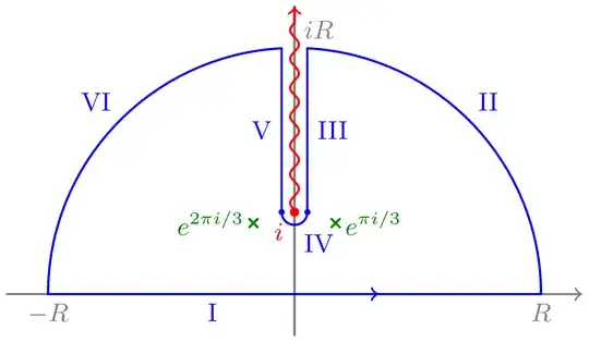

Here's an approach just using contour integration and the Residue Theorem.
Denote the integrand by $$g(z) := \frac{\log(1 + z^2)}{z^4 + z^2 + 1}$$ and the contour indicated in the diagram by $\Gamma_{\epsilon, R}$, $0 < \epsilon < \frac{\sqrt 3 - 1}{\sqrt 2}$, $1 < R$; we use the standard choice of branch cut for logarithm, so that $\arg z = \Im z \in (-\pi, \pi)$. The wavy red curve indicates the part of the consequent branch cut for $\log(1 + z^2)$ in the upper half-plane.
The contour of integration
We evaluate $$\oint_{\Gamma_{\epsilon, R}} g(z) \,dz$$ in two ways: using direct integration and via the Residue Theorem. We denote by $\textrm{I}, \ldots, \textrm{VI}$ the arcs so labeled in the diagram.
By design, $$\lim_{R \to \infty} \int_\textrm{I} g(z) \,dz = \int_{-\infty}^\infty \frac{\log(x^2 + 1) \,dx}{x^4 + x^2 + 1}$$ is the integral whose value we want to compute.
Now, $$\left\vert\int_\textrm{II} g(z) \,dz\right\vert \leq \int_\textrm{II} |g(z)| \,|dz| \leq \frac{\pi}{2} \cdot \frac{\log(R^2 + 1)}{R^4 - R^2 - 1},$$ which (by, e.g., l'Hôpital's Rule) approaches to $0$ as $R \to \infty$. So, $\lim_{R \to \infty} \int_\textrm{II} g(z) \,dz = 0$. For the same reason, $\lim_{R \to \infty} \int_\textrm{VI} g(z) \,dz = 0$.
We parameterize the integral over $\textrm{V}$ by $z = \epsilon - i t$, $dz = i \,dt$, where $t$ varies from $1$ to $R$: $$\int_\textrm{V} g(z) \,dz = \int_1^R \frac{\log[(-\epsilon + it)^2 + 1]}{(-\epsilon + i t)^4 + (\epsilon + i t)^2 + 1},$$ and in the limit as $\epsilon \searrow 0$, this is $$\lim_{\epsilon \searrow 0} \int_\textrm{V} g(z) \,dz = i \int_1^R \frac{\log(t^2 - 1) - \pi i}{t^4 - t^2 + 1}\,dt .$$ Parameterizing the integral over $\textrm{III}$ by $z = \epsilon + i t$, $dz = i \,dt$ similarly gives $$\lim_{\epsilon \searrow 0} \int_\textrm{III} g(z) \,dz = -i \int_1^R \frac{\log(t^2 - 1) + \pi i}{t^4 - t^2 + 1}\,dt,$$ so $$\lim_{\epsilon \searrow 0} \left[\int_\textrm{III} g(z) \,dz + \int_\textrm{V} g(z) \,dz\right] = 2 \pi \int_1^R \frac{dt}{t^4 - t^2 + 1} ,$$ and in the limit as $R \to \infty$, \begin{multline*} \lim_{\epsilon \searrow 0, R \to \infty} \left[\int_\textrm{III} g(z) \,dz + \int_\textrm{V} g(z) \,dz\right] \\ = 2 \pi \int_1^\infty \frac{dt}{t^4 - t^2 + 1} = 2 \pi \left(\frac{\pi}{4} - \frac{\log(2 + \sqrt{3})}{2 \sqrt{3}}\right) = \frac{\pi^2}{2} - \frac{\pi}{\sqrt 3} \log (2 + \sqrt 3) .\end{multline*}
Finally, parameterizing the half-circle $\textrm{IV}$ by $z = i + \epsilon e^{i \theta}$, $dz = i \epsilon e^{i \theta} \,d\theta$ gives $$\int_\textrm{IV} g(z) \,dz = i \int_0^{-\pi} \frac{\epsilon \log [1 + (i + \epsilon e^{i \theta})^2] e^{i \theta} \,d\theta}{(i + \epsilon e^{i \theta})^4 + (i + \epsilon e^{i \theta})^2 + 1}.$$ We have the bound $$\left\vert\int_\textrm{IV} g(z) \,dz\right\vert \leq \int_\textrm{IV} |g(z)| \,|dz| \leq \frac{\epsilon (2 + 2 \pi + |\log \epsilon| + \epsilon)}{1 - 12 \epsilon} \cdot \pi\epsilon \in O(\epsilon^2 \log \epsilon),$$ so by l'Hôpital's Rule $$\lim_{\epsilon \searrow 0} \int_\textrm{IV} g(z) \, dz = 0 .$$
In summary we have $$\phantom{(\ast)} \qquad \oint_{\Gamma_{\epsilon, R}} g(z) \,dz = \int_{-\infty}^\infty \frac{\log(x^2 + 1) \,dx}{x^4 + x^2 + 1} + \left[\frac{\pi^2}{2} - \frac{\pi}{\sqrt 3} \log (2 + \sqrt 3)\right]. \qquad (\ast)$$
On the other hand, the only poles of $g$ inside the contour are the simple poles at $e^{\pi i / 3}, e^{2 \pi / 3}$, and computing directly gives $$ \operatorname{Res}\left(g; e^{\pi i / 3}\right) = \frac{\pi}{12 \sqrt{3}} - \frac{\pi}{12} i \qquad \textrm{and} \qquad \operatorname{Res}\left(g; e^{2 \pi i / 3}\right) = -\frac{\pi}{12 \sqrt{3}} - \frac{\pi}{12} i ,$$ so the Residue Theorem yields $$ \phantom{(\ast\ast)} \qquad \oint_{\Gamma_{\epsilon, R}} g(z) \,dz = 2 \pi i \left[\operatorname{Res}\left(g; e^{\pi i / 3}\right) + \operatorname{Res}\left(g; e^{2\pi i / 3}\right)\right] = 2 \pi i \left(-\frac{\pi i}{6}\right) = \frac{\pi^2}{3}. \qquad (\ast\ast) $$ Combining $(\ast)$ and $(\ast\ast)$ gives the desired value: $$\int_{-\infty}^\infty \frac{\log(x^2 + 1) \,dx}{x^4 + x^2 + 1} = \boxed{\frac{\pi}{\sqrt 3} \log (2 + \sqrt 3) - \frac{\pi^2}{6}} .$$
