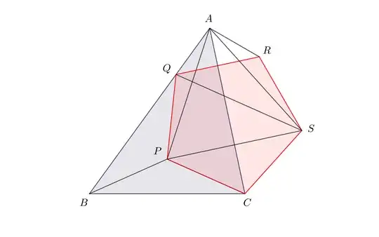

  1. Let $Q$ on $AB$ such that $PQ \cong PB \cong PC$.
  2. By angle chasing, $\measuredangle QPC = 108^\circ$. Hence we can construct the regular pentagon $PQRSC$ shown above, where, in particular, $AC$ perpendicularly bisects $QR$.
  3. $\triangle AQR$ is isosceles, and angle chasing yields $\measuredangle AQR = 42^\circ$.
  4. Let now $A'$ on $CA$ (on the same side as $A$, with respect to $PS$) such that $\triangle PA'S$ is equilateral. We will show that $A' \equiv A$. We have in fact that $\triangle A'QS$ is isosceles, and angle chasing gives $\measuredangle A'SQ = 24^\circ$. Hence $\measuredangle A'QS = 78^\circ$, $\measuredangle A'QR = 42^\circ$, and by 3. we have our conclusion.
  5. So $\measuredangle PAS = 60^\circ$, that is $\measuredangle PAC = 30^\circ$, hence the result $$\boxed{\measuredangle BAP = 18^\circ}.$$
dfnu
  • 8,050

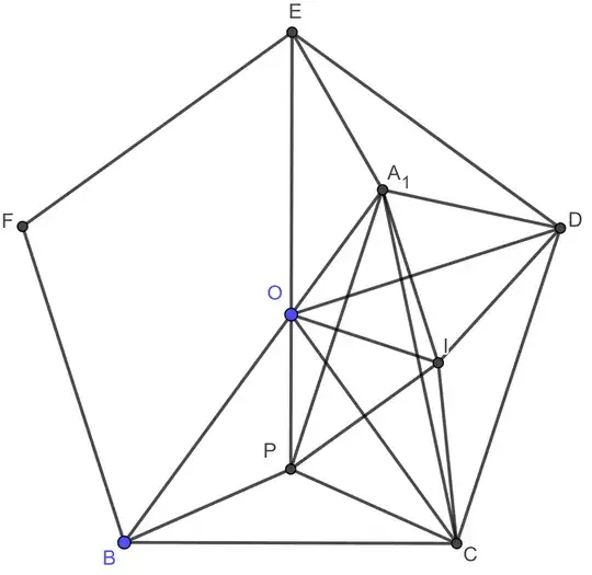

Let draw regular pentagon BCDEF with center O. Let P is point such that $\angle PBC=\angle PCB=24$°, I is point such that $\angle ICD=\angle IDC=24$°, A$_1$ is point such that $\angle A_1DE=\angle A_1ED=24$°. Triangles PIC and A$_1$ID are regular and equal. Then triangle $A_1IC$ is isosceles with $\angle A_1IC=360$°$-60$°$-132$°$=168$°, then $\angle ICA_1=6$°, $\angle PCA_1=54$°.
A$_1$, O and B lie on perpendicular bisector of the edge DE, then $\angle A_1BP=\angle OBP=30$°. Then A$_1$ is the same point as A from problem statement. Then $\angle BAP=\angle OA_1P=18$°
Ivan Kaznacheyeu
  • 4,298
  • 10
  • Thanks! I like your solutions the most! It’s short and explains the “hidden” symmetry of the original figure! – Lydia Lee May 27 '23 at 06:06

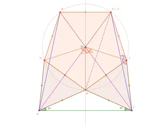

Here is a great party, so i will join. The point $\Omega$ below also shows up in many other solutions, but somehow i missed a quick argument.
Construct on $BP$ and $CP$ two equilateral triangles $\Delta BPQ$ and $\Delta CPT$ as in the picture. The perpendicular bisectors of $PQ$ (which also passes through $A,B$) and of $PT$ intersect in a point, call it $\color{blue}\Omega$, which also lies on the perpendicular bisector of $BC$. We obtain now by symmetries $\color{blue}\Omega Q=\color{blue}\Omega P=\color{blue}\Omega T$, and $\Delta \color{blue}\Omega BC$ isosceles, so we know the angles: $$ \widehat{Q\color{blue}\Omega P}= \widehat{P\color{blue}\Omega T}=72^\circ\ . $$ enter image description here
This means that we can extend the broken line $TPQ$ to a regular pentagon $TPQRS$, with center of symmetry in $\color{blue}\Omega$ as in the picture. The marked angle in $T$ in the isosceles $\Delta TSC$ is $60^\circ+108^\circ$, so $\widehat {TCS}=6^\circ$, giving $\widehat {SCP}=60^\circ-6^\circ=54^\circ=\widehat {ACP}$. The point $S$ is thus $S=B\color{blue}\Omega A \cap CA=A$. Finally: $$ x=\widehat{BSP}=\widehat{\color{blue}\Omega SP}= \frac 12\widehat{QSP}=\frac 12\cdot 36^\circ=\bbox[yellow]{\ 18^\circ \ }\ . $$
dan_fulea
  • 37,952
  • Thanks! I believe the $BT$ in the forth line of your solution should be $PT$. – Lydia Lee May 27 '23 at 05:39
    It is interesting that the three main approaches here have in common that a point defined in some other way is shown to coincide with $A$. Personally, I tried to go the other way around and show directly that $A$ is the vertex of an equilateral triangle, but failed in doing so. – dfnu May 27 '23 at 11:11
  • Yes, it is $PT$ at an important first point in the story, correcting it, thanks! – dan_fulea May 27 '23 at 13:27

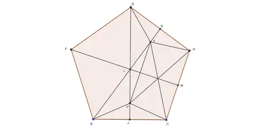

Construct a regular pentagon on $BC$. Since $\angle ABC=54^o$, then $BA$ bisects $\angle FBC=108^o$, and $BAK$ is the perpendicular bisector of $GH$. Similarly, since $\triangle BPC$ is isosceles, $GPJ$, crossing $BK$ at $L$, perpendicularly bisects $BC$, and $FLM$ perpendicularly bisects $CH$.
angle BAP Thus if we join $PH$, $AG$, and $AH$, we have $\triangle PGH\cong\triangle ABC$, and $\triangle HAG\cong\triangle BPC$.
By symmetry then, $\triangle LAP$ is isosceles. And since exterior $\angle KLG=180^o-90^o-54^o=36^o$, then $\angle LAP=\angle APL=18^o$.
    How do you know that $\triangle PGH\cong\triangle ABC$ ? – Ivan Kaznacheyeu May 26 '23 at 07:24
    @Piita: the two mentioned triangles have a congruent side, and the opposite vertex of each of them lies on the other triangle perpendicular bisector. But without knowlegde of angles one cannot conclude that the triangles are congruent, I believe. (Basically, the "position" of $A$ and $P$ on each perpendicular bisector is not shown to be the same.) – dfnu May 26 '23 at 13:30
    @dfnu I stand corrected, there's an angle-chasing part missing, to show AK=PJ, or that AP is indeed perp. to LM or parallel to CH. – Piita May 26 '23 at 15:56
  • @IvanKaznacheyeu—Your question and the other comments are all justified; my argument is flawed. – Edward Porcella May 26 '23 at 20:25
