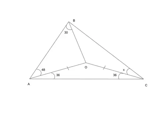

I have a problem here solving this without trigonometry. We have an acute triangle. Is given the following. enter image description here Find the $\angle$ BCO.
I tried different approaches. The continuation of CO intersects AB in point M, such that we get an isosceles triangle BMO. I have taken the mid-vertical of AB and found useful angles. I take P on AB such that the $\angle$ AOP = 48°. So I will get POS isosceles triangle with PO = OC and $\angle$ CPO = $\angle$ PCO = 6°. Let the intersection point of BO and CP be K. $\angle$ KOP = 18°. $\angle$ OKC = 24°. I have $\angle$ OCP, now I need to find $\angle$ BCK, to find x.
I tried other approaches also but still did not find the solution.

  • I added the question in the body, we need to find the angle BCO. – Zhenya Karapetyan May 20 '23 at 16:19

  • First of all, thanks for your interest. This problem is eating my brain for 2 weeks now. I know that the answer is 24°. Maybe it can help us. I try to construct isosceles triangles to find angles. This is hard problem with simple rules. I would also like to know why is this question downvoted, because I have edited it properly:) – Zhenya Karapetyan May 31 '23 at 14:35
  • The answer is $18^{\circ}$ as @PaulSinclair noted. I verified it :) Perhaps you can edit your question to include the method you solved it with trig... – Amit May 31 '23 at 14:41

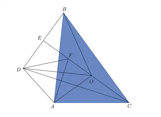

  • @PaulSinclair I tried using plain euclidean geometry, by not directly translating trigonometric values into lenght ratios. The graph is not too messy, I hope. – dfnu Jun 02 '23 at 10:31
Construct the equilater triangle $\triangle BOD$ as shown above and produce $OC$ to $E \in BD$. Take $F\in CE$ in such a way that $AF\cong AO$.
  1. $AB$ perpendicularly bisects $OD$, hence $\measuredangle AOD = 42^\circ$, and $\triangle AOD$ is isosceles.
  2. Then also $\triangle DAF$ is isosceles, since $AF \cong AO \cong AD$.
  3. Angle chasing yields $\measuredangle AFC = \measuredangle FAC = 72^\circ$, so that $\triangle AFC$ is isosceles, too.
  4. We get $\measuredangle FAD = 60^\circ$, so by 2. $\triangle DAF$ is in fact equilateral.
  5. The quadrilateral $ACFD$ is thus a kite, whose diagonal $DC$ bisects its internal angles. Therefore, using 3., $\measuredangle OCD = 18^\circ$.
  6. Finally, since by angle chasing $\measuredangle EOD = 30^\circ$, $CE$ perpendicularly bisects $DB$; by 5., $$\measuredangle OCD = \boxed{\measuredangle OCB = 18^\circ}.$$

  • Why is $\triangle DAF$ isosceles? – Paul Sinclair Jun 02 '23 at 11:35
    @PaulSinclair $AF \cong AO$ by construction, and $AO \cong AD$, by 1. – dfnu Jun 02 '23 at 11:39
    Impressive, opened another horizon of mind!) – Zhenya Karapetyan Jun 02 '23 at 13:24
  • It's a really elegant solution, I was of late trying an approach that exploits the fact that $36^{\circ}$ happens to be $2\pi / 10$ so I tried to see if by drawing a diagram with such $10$ rotated copies of the triangle any new insight can come to mind. I guess I'll stop now :) But as an aside, this solution does make me wonder, whether this same construction you used, is the same that was used in constructing the problem :) – Amit Jun 02 '23 at 14:17
    @Amit thanks for appreciating. You can also try with regular pentagons. See e.g. the similar problem https://math.stackexchange.com/questions/4705518/p-is-a-point-in-triangle-abc-with-angle-pbc-angle-pcb-24-circ-angl/4706568#4706568 – dfnu Jun 02 '23 at 15:18
