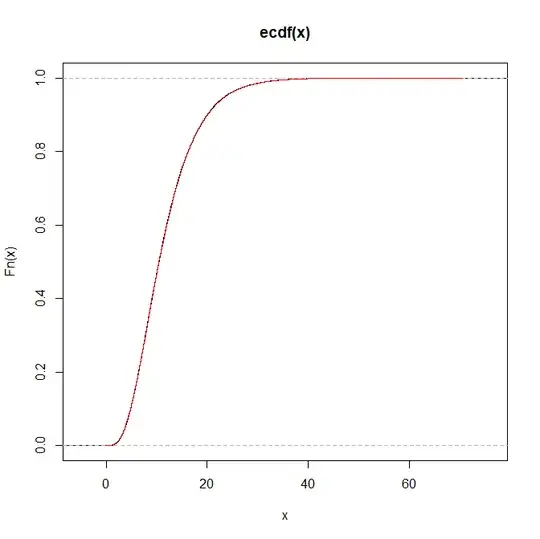

To illustrate this with a simulation in R, consider $n=4$ and $\lambda=0.1$:

and the theoretical CDF in red matches the simulated empirical CDF in black
plot.ecdf(sims)
curve(1 - (6*exp(-2*x*lambda)-3*exp(-4*x*lambda)-2*exp(-6*x*lambda)) +
          12*x*lambda*exp(-4*x*lambda),
      from=0, to=max(sims), col="red", add=TRUE)
CDFs
