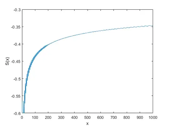

Some partial results seem to indicate that the suggested limit is not $-1/2$. From numerical simulations with $x$ increasing up to 1 million or so, I observed that the sum exhibits oscillations which increase in amplitude and decrease in frequency w.r.t. to $x$. This would suggest that the integral diverges. However, I seem to be unable to find a proof for this, as my initial plan to evaluate the integral with the stationary phase method fails. Hence, at the moment all this remains as speculations.

As a sanity check, e.g. letting $x=10$ gives that the original sum equals $-0.5209$ whereas numerical integration gives $-0.5208$. Calculating the the value of $S(x)$ for $x$ ranging between $0$ and $1000$ gives the result below.

    Nice plot and observations. I think I can prove convergeance but It will take some time. I also noticed your plot seems to approach $\frac{-1}{\pi}$ but we need more data ofcourse. It would be fun if it would be true. However I still think it could be $\frac{-1}{2}$ because I think the values go up and down first. – mick May 17 '23 at 20:20
    @mick, From the simulations, the sum doesn’t seem to approach a specific value for x ranging from 1 to 1 million, given that the numerical integration works. I can add some additional figures if would make things clearer. My best vet is that the sum diverges but it would be nice to arrive at a proof whether this is true or not. So I hope you’ll arrive at an answer! I think this approach can be used to evaluate the other sum you had asked about earlier, I have some rehersing on complex analysis to do but eventually I hope to be able to give an alternative answer to that question. – AxelT May 18 '23 at 08:05
