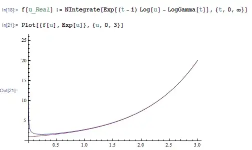

Using $$\int_0^\infty \left(2 n\right)^{-t} \mathrm{d} t = \frac{1}{\ln(2n)}$$ the sum becomes $$ \sum_{n=1}^\infty (-1)^n \frac{x^{2n-1}}{(2n)! \cdot \ln(2n)} = \int_0^\infty \left(\sum_{n=1}^\infty (-1)^n \frac{x^{2n-1}}{(2n)! \cdot (2n)^t} \right)\mathrm{d}t $$ Now, further using $$ \int_0^\infty u^{t-1} \mathrm{e}^{-2 n u} \mathrm{d} u = \Gamma(t) (2n)^{-t} $$ we rewrite the sum as a double integral: $$ \sum_{n=1}^\infty (-1)^n \frac{x^{2n-1}}{(2n)! \cdot \ln(2n)} = \int_0^\infty \left( \int_0^\infty \frac{u^{t-1}}{\Gamma(t)}\mathrm{d}t \right) \frac{\cos\left(x \mathrm{e}^{-u}\right)-1}{x} \mathrm{d} u $$ In the large $x$ limit, the main contribution to the integral comes from large $u$. For large $u$, $$ \int_0^\infty \frac{u^{t-1}}{\Gamma(t)}\mathrm{d}t \approx \sum_{t=1}^\infty \frac{u^{t-1}}{\Gamma(t)} = \mathrm{e}^{u} $$ enter image description here
Thus: $$ \begin{eqnarray} \lim_{x \to \infty} \sum_{n=1}^\infty (-1)^n \frac{x^{2n-1}}{(2n)! \cdot \ln(2n)} &=& \lim_{x \to \infty} \int_0^\infty \mathrm{e}^{u} \frac{\cos\left(x \mathrm{e}^{-u}\right)-1}{x} \mathrm{d} u = \lim_{x \to \infty} \int_1^\infty \frac{\cos\left(x/w\right)-1}{x} \mathrm{d} w \\ &=& \lim_{x \to \infty} \int_{1/x}^\infty \left(\cos\left(\frac{1}{v}\right)-1\right) \mathrm{d} v = \int_{0}^\infty \left(\cos\left(\frac{1}{v}\right)-1\right) \mathrm{d} v \\ &=& -\frac{\pi}{2} \end{eqnarray} $$

    Euh i did not get all those steps. It would be helpful if you explained what substitutions or partials you used. Also a plot is not a proof although i guess you know that and its not crucial to the proof. – mick Sep 04 '12 at 19:28
    Masterful, +1 . – Jonathan Sep 04 '12 at 19:33
  • @mick Sorry for being sketchy. Large $u$ behavior of $\int_0^\infty \frac{u^{t-1}}{\Gamma(t)} \mathrm{d} t$ can also be obtained using Laplace's method. I used Euler-Maclaurin formula. Could you please tell me more precisely which steps you did not get. Those at the end of the post, or some others? – Sasha Sep 04 '12 at 19:37

  • @ Sahsha I feel silly for not understanding , but you already lost me at the double integral. blush – mick Sep 04 '12 at 19:55
    $$ \int_0^\infty \left( \sum_{n=1}^\infty (-1)^n \frac{x^{2n-1}}{(2n)!} \frac{1}{(2n)^t} \right) \mathrm{d} t = \int_0^\infty \left( \sum_{n=1}^\infty (-1)^n \frac{x^{2n-1}}{(2n)!} \frac{1}{\Gamma(t)} \int_0^\infty u^{t-1} \mathrm{e}^{-2n u} \mathrm{d} u \right) \mathrm{d} t = \int_0^\infty \int_0^\infty \frac{u^{t-1}}{\Gamma(t)} \left( \sum_{n=1}^\infty (-1)^n \frac{x^{2n-1}}{(2n)!} \mathrm{e}^{-2n u} \right) \mathrm{d} u \mathrm{d} t $$ The latter sum evaluates to $\frac{\cos(x \mathrm{e}^{-u})-1}{x}$. – Sasha Sep 04 '12 at 20:00
  • Thanks. Off course. Excellent use of the gamma function. – mick Sep 04 '12 at 20:45
