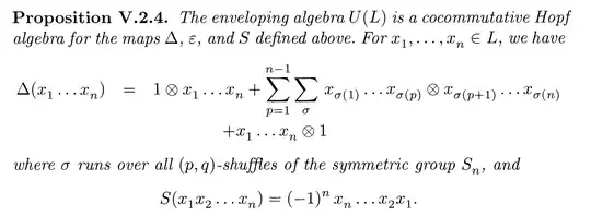

  • @CaptainLama I added a formula for comultiplication that I know – Emptymind Apr 20 '23 at 19:41

Denote the multiplication map of $U(L)$ by $m: U(L) \otimes U(L) \rightarrow U(L)$. For every $x \in U_m$, we know $m\Delta(x)$ lies in $U_m$. This can be proved directly, but you may use the proposition in your question. However, if $x \in U_m \setminus U_{m-1}$ is a grouplike element, then $m\Delta(x)= m(x \otimes x) = x^2$ has a nonzero homogeneous part of degree $2m$. If follows that $m \geq 2m$, or $x$ is a scalar. Now $\Delta(x) = x \Delta(1)=x (1 \otimes 1)$ should be equal to $x\otimes x = x^2 (1 \otimes 1)$, whence $x = 1$.
