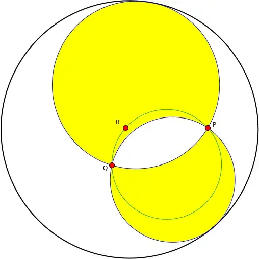

The limit between a circumscribed circle lying within the unit circle and a circumscribed circle crossing the unit circle is a circumscribed circle which touches the unit circle in a single point. This is a special case of Appolonius' problem, and https://en.wikipedia.org/wiki/Special_cases_of_Apollonius%27_problem#Type_5:_One_circle,_two_points has instructions for how to construct such touching circles. I also wrote an answer in the past where I used Lie geometry to compute specific solutions to Apollonius' problem.
For your given points $P$ and $Q$ you would in the general case get two circles through these points and touching the unit circle. A circle though $P$, $Q$ and a third point $R$ lies within the unit circle if and only if $R$ lies within one of the Apollonius circles but outside the other. That's the yellow area in the following figure:
Apollonius' circle configuration
The probability of the point $R$ falling inside the yellow area is equal to the ratio between that yellow area and the total area of the unit disk. So at this stage you'd compute the two touching circles, Sum their area but make sure to exclude the area where they overlap, and that's your function $f$ for your probability integral.
