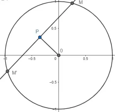

Let us rephrase the issue in a different way.
Let $(C)$ be the circle with center $(a,b)$ and radius $r$, i.e., with equation :
$$(x-a)^2+(y-b)^2-r^2=0$$
This circle induces two regions in the plane:
  • the set of points $(x,y)$ such that $(x-a)^2+(y-b)^2-r^2<0$ which is the interior of (C).
  • the set of points $(x,y)$ such that $(x-a)^2+(y-b)^2-r^2>0$ which is the exterior of (C).
This article "4160" expresses the equality between two ways of describing the power of an interior point $P$ with respect to circle $(C)$:
$$\mathfrak{P}(P,(C))=\begin{cases}(x-a)^2+(y-b)^2-r^2<0\\ \underbrace{\vec{PM}.\vec{PM'}}_{\text{dot product}}=\underbrace{-PM.PM'}_{\text{opposite of lengths' product}}=-PM^2\end{cases}$$
(see the answer by Blue to this question).
More explanations : The way one must understand the word "ordinates" is probably due to the fact that $OP$ is implicitly taken as a natural abscissa axis whereas the other one $MM'$ called traditionaly "conjugate", in this case the orthogonal axis to $OP$. Said otherwise : consider all lines parallel to $MM'$ : their midpoints are aligned along a line which is line $OP$ like in this recent question here.
