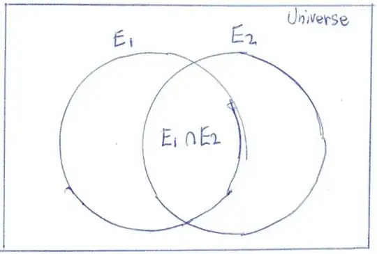

To answer this question, I will need to stretch your intuition. First, consider the following diagram.
In the diagram, the enclosed rectangle represents the Universe, and the two circles represent events $~E_1~$ and $~E_2.~$ Now, consider two questions:
  • Based on the diagram, what is the physical representation of the probability of event $E_2$ occurring?
    Answer : It is the fraction $~~\displaystyle \frac{\text{Area of the circle}~E_2}{\text{Area of rectangle} ~\textit{Universe}}.$
  • Based on the diagram, what is the physical representation of the probability of event $(E_2|E_1)$ occurring, which represents the probability of event $~E_2~$ occurring, under the assumption that event $~E_1~$ has occurred?
    Answer : It is the fraction $~~\displaystyle \frac{\text{Area of the intersection}~E_1 \cap E_2}{\text{Area of the circle}~E_1}.$
The point of the bullet point questions/answers is to stretch your intuition, around these ideas.
The mathematical equation that represents the answer to second bullet point question above is
$$\displaystyle p(E_2|E_1) = \frac{p(E_2 \cap E_1)}{p(E_1)}.$$
Before you proceed further, reviewing this section of my answer, I suggest you read the Wikipedia - Conditional Probability. Note that this Wikipedia article uses the variable $~A~$ to represent event $~E_2~$ and the variable $~B~$ to represent $~E_1.$
Now, please refer back to the diagram. Using my variables, $~E_2~$ and $~E_1,~$:
  • Let $~A~$ denote the probability of the events $~E_1~$ and $~E_2~$ both occurring.
    That is, $~A = p(E_1 \cap E_2).~$
  • Let $~B~$ denote the probability of the events $~E_1~$ and $[\neg E_2]~$ both occurring.
    That is, $~B = p(E_1 \cap [\neg E_2]).~$
This implies that $~p(E_1) = A + B.$
This explains why
$$p(E_2 ~| ~E_1) = \frac{p(E_1 \cap E_2)}{p(E_1)} = \frac{A}{A+B}.$$
Now, it remains to interpret the problem, so as to find a convenient choice, for events $~E_1~$ and $~E_2.$
You are given that $~n~$ consecutive positive results have occurred. You are then asked for the probability that the patient has the virus.
So, I let :
  • $~E_1~$ denote the event that $~n~$ consecutive positive results occurred.
  • $~E_2~$ denote the event that the patient has the virus.
Therefore, I am being asked to compute $~p(E_2 ~| ~E_1).$
If you review the start of my answer, you will see that I am (in effect) letting:
  • $~A~$ denote the $~p(E_1 \cap E_2).$
  • $~B~$ denote the $~p(E_1 \cap [\neg E_2]).$
This explains my computation $~\dfrac{A}{A + B}.$
