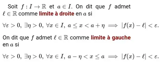

While I am reading some books about analysis, i found that the definitions used for the notion of the limit from the right and the limit from the left are not always the same in all the references. Some references give the definitions as follows:enter image description here

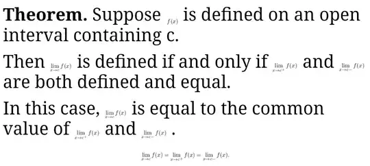

Note that the definition above takes in accounting that $x$ may take the value of $a$ which guarantee the equivalence given in the following theorem:

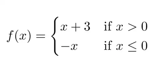

enter image description here Whereas some other references use the following definitions: enter image description here but in this case the previous theorem will not hold, we can for example define a function $f$ to be $1$ at $x_{0}=0$ and to be $x$ at $x\neq0$, the limit from the right and the limit from the left at $0$ for this function will $0$ but $f$ doesn't have a limit! and if we choose the first definition then I think that many examples have been solved in the wrong way, for instance let's take the following function: enter image description here usually we say that the limit from the right of $0$ is $3$ but in fact if we apply the first definition we will find that the limit from the right of $0$ doesn't exist! Do you have any suggestions to deal with this situation?
    The first definition forces $f(a) = \ell$, right? That seems incorrect or not standard. The value of $f$ at $a$ is not supposed to matter. Maybe some authors use a different convention than what I’m used to. – littleO Feb 17 '23 at 02:48
  • Si tu appliques la première définition tu trouves bien $3$ à droite et $0$ à gauche car $\eta$ est positif dans ta première définition. – EDX Feb 17 '23 at 02:58
  • If $f(0)=0$ and $f(x)=x$ when $x\neq0,$ (the function $f$ that you say doesn't have a limit), then $f(x)=x$ for all $x$, and $f$ is a continuous function everywhere with a limit everywhere. – David K Feb 17 '23 at 04:50

    It depends on what your definition of limit is in the first place. Do you use $0 < |x-a| < \delta$ or just $|x-a| < \delta$? Some related questions: https://math.stackexchange.com/questions/2768350/french-limits-are-different, https://math.stackexchange.com/questions/3298744/mistake-in-french-wikipedia-on-definition-of-limit, https://math.stackexchange.com/questions/1794652/deleted-versus-non-deleted-limits – Hans Lundmark Feb 17 '23 at 07:35
