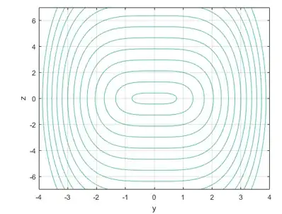

For convenience, we rewrite the original equation in the form of a system: $$\tag{1} \left\{\begin{array}{lll} \dot y&=&z\\ \dot z&=&-y^3. \end{array}\right. $$ The system (1) has the first integral/conserved quantity $$ V(y,z)= \frac14 y^4+\frac12 z^2. $$ It means that it remains constant along the trajectories of (1). Indeed, let $(y(t),z(t))$ be the solution to (1). Then the derivative along the trajectories $$ \dot V= \frac{d}{dt}V(y(t),z(t))= \frac{\partial V}{\partial y}\frac{dy}{dt}+ \frac{\partial V}{\partial z}\frac{dz}{dt}= y^3z+z(-y^3)\equiv 0. $$ This implies that any solution trajectory $(y(t),z(t))$ lies on the level curve of $V$. These level curves are closed: Level curves
To prove that the solutions are periodic, one can use the uniqueness of the solution to the initial value problem. If the solution, having passed along a closed trajectory, returned to the starting point, then the next turn will be identical to the one passed due to the coincidence of the initial conditions. On the other hand, the state cannot stop halfway without going through a full turn along a closed curve, since for any fixed curve the velocity of the movement $$ \sqrt{(\dot y)^2+(\dot z)^2}=\sqrt{z^2+y^6} $$ is bounded from below, except for the equilibrium point $(0,0)$. As a result, the state travels a finite distance on the phase plane in a finite time.
