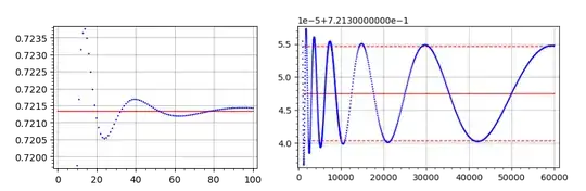

Formulas for $P[X_n=1]$ can be obtained by noting that there is a bijection between (a) length-$n$ binary sequences with a unique longest run, and (b) compositions of $n+1$ with a unique largest part, such that these are equal in number. Calling this number $a(n)$, we thus have $P[X_n=1]={a(n)/ 2^n}$. The sequence $a(n)$ is listed at OEIS A097979, which gives both a generating function and a Mathematica program. The following pictures show the "almost convergence" of $P[X_n=1]$, which has interesting oscillations as $n\to\infty$:
probability that longest run is unique
The sequence has been proved$^\dagger$ to oscillate around $1/(2\log 2)$ (solid red line) with ever-decreasing amplitude, the amplitude converging to $0.00000713...$ as $n\to\infty.$ (For $n>30$ it's infeasible to directly count the sequences that have a unique longest run, so for larger $n$ up to $10000$ I used a SageMath translation of the Mathematica program, and for $n>10000$ I used the generating function (with help from ask.sagemath). The plot on the right shows only every tenth point up to $n=10000$, and every hunderdth point thereafter. (The changeover at 10000 is visible in the spacing of the dots, which also decreases as the slope decreases.)
