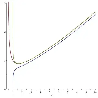

I'm not how much there is to say here. At any rate in order to make sense of the function, we should interpret $y!$ as $\Gamma(y + 1)$, where $\Gamma$ denotes the gamma function, and hence our function $x \mapsto (\log x)!$ as $x \mapsto \Gamma(\log x + 1)$, with which it coincides on the nonnegative integers and which is defined everywhere except at the nonpositive integers. (This extension is the best one possible in a sense made precise by the Bohr-Mollerup Theorem.)
We can immediately read off properties of $x \mapsto (\log x)!$ from those of $\Gamma$: For example, $x \mapsto (\log x)!$ has simple poles precisely at $e^{-1}, e^{-2}, e^{-3}, \ldots$ and hence domain $(0, \infty) \setminus \{e^{-1}, e^{-2}, e^{-3}, \ldots\}$, and its range is $\Bbb R \setminus \{0\}$. The function's (unique) minimum occurs at $\beta = e^{\alpha - 1} = 1.58666\ldots$, where $\alpha = 1.46163\ldots$ is the location of the unique minimum of $\Gamma$ on $(0, \infty)$, and $x \mapsto (\log x)!$ is strictly monotone on $[\beta, \infty)$.
Stirling's approximation gives the (peculiar-looking) asymptotic formula as $n \to \infty$: $$(\log x)! = \sqrt{2 \pi} \frac{(\log x)^{\log x + \frac{1}{2}}}{x} \left(1 + O((\log x)^{-1})\right) .$$ Using an additional term of the expansion of $\Gamma(y + 1)$ at $\infty$ gives a better approximation for large $x$: $$(\log x)! \sim \sqrt{2 \pi} \frac{\log x^{\log x - \frac{1}{2}} (12 \log x + 1)}{12 x} .$$ In fact, already at $x = 2$ the relative error of the latter formula is smaller than $1$ part in $1\,300$.
Plot of (\log x)! and the two given approximations
The red curve is the graph of $(\log x)!$, the blue curve is the graph of the leading term of the above asymptotic formula, and the green curve is the graph of the second, better approximation.
As some of the commenters have mentioned, it's more common to consider $\log (x!) = \log \Gamma(x + 1)$; indeed $\log \Gamma$ is simply called the log-gamma function.
