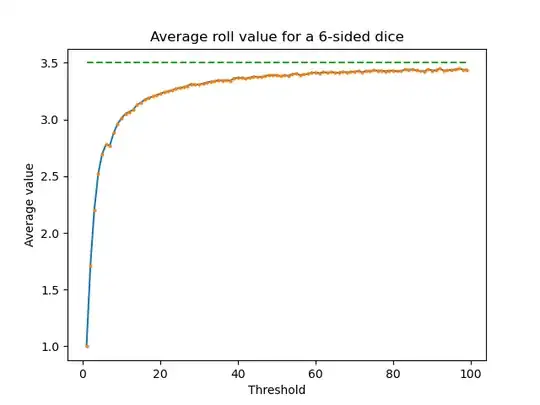

Simulations I made using python :
Average roll value for a 6-sided dice and varying threshold

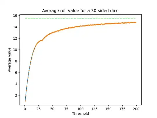

Average roll value for a 30-sided dice and varying threshold

  • Could you give more details please? e.g. for 6 sides and $T=2$, if we get any value between 2 and 6 it is counted as a 2? So with probability 5/6 it is 2, and probability 1/6 it is 1, so the expected dice roll value is 25/6+11/6=11/6? But in your simulation it looks like we are under 1.5 for $T=2$, yet $11/6\simeq1.83$. Is there something I didn't understand? – Will Sep 11 '22 at 11:51
  • @Will Yes, any value between 2 and 6 will be counted as 2, but only if it happens on the first roll. If the first roll is a 1, the 2nd roll will always be counted as 1. This means that the average roll is worth 1.714, not 1.83. I've edited the graphs to make it easier to see the average values for each threshold. – danaedf Sep 12 '22 at 01:04
