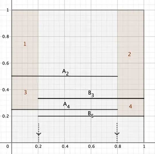

Edit: Martin R seems to have provided a clever counter-example showing the answer to my question is no. I am still hopeful of getting the result I need as $X$ is actually the image, by an open map (a projection), of an $n$-dimensional integral manifold $L$. Given bounds on the partial derivatives of $L$ (and perhaps an additional restriction on the second derivative) I can use estimates on the minimum size of the image, in $X$, of any open "ball" in $L$ to show that, for every $x \in X$, if $U_x$ is a neighborhood of $x$ completely contained in $X$ then it must contain a ball of minimum radius (I have questions about these estimates, I will create another post to pose them). This obviously would get around counter examples such as the one provided by Martin R. My thanks to all who posted and tried to help.
