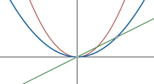

Let $X=\{(x,y)\in\Bbb R^2\mid x^2<y<2x^2\}$ and $z=(0,0)$.
math 4526753 In Euclidean space can you always find a sequence approaching a limit point along a line?  Made by https://www.desmos.com/calculator
Let $\ell$ be a line through $z$.
  • $\ell$ is line $x=0$ or line $y=0$. Then $\ell$ does not intersect $X$.
  • $\ell$ is $y=kx$ for some $k\not=0$. Then the open ball $B(z, |k|/2)\cap X$ does not intersect $\ell$.
