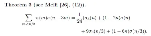

A similar problem to this problem (ccorn has given a nice answer to it). Prove that $$\sum_{\substack{0<k<3^n\\3\nmid k}}\sigma{(3^n-k)}\sigma{(k)}=6\cdot27^{n-1},$$ where $\sigma(N)$ is defined as $$\sigma{(N)}=\sum_{d\mid N}d.$$
I find this:(From Elementary Evaluation of Certain Convolution Sums Involving Divisor Functions by Huard et al. On page 20)
so we are done.
