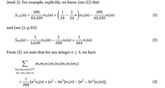

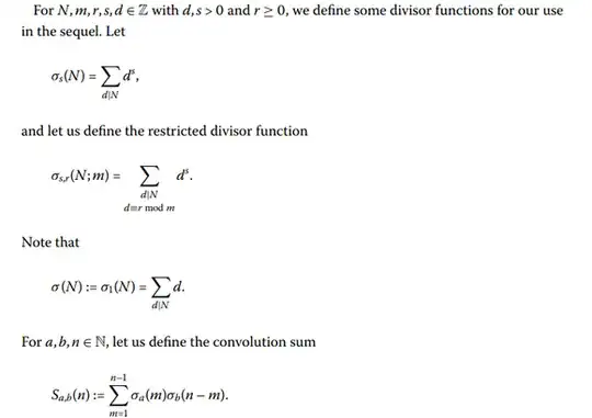

and I find some of this enter image description here
or can see:http://www.advancesindifferenceequations.com/content/pdf/1687-1847-2013-84.pdf
