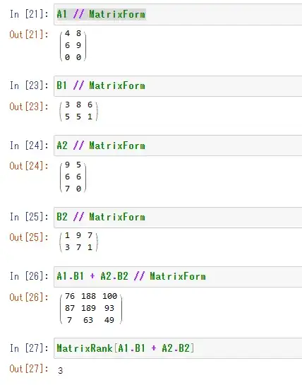

I found the following example:
$\operatorname{rank}(A_3B_3)\leq\min\{\operatorname{rank}A_3,\operatorname{rank}B_3\}\leq 2$ for any $3\times 2$ matrix $A_3$ and any $2\times 3$ matrix $B_3$.
