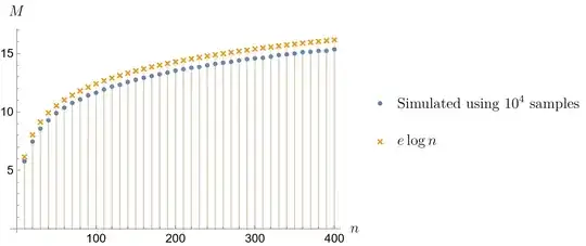

The figure below compares simulated values of $M_n$ and the values of the asymptotic formula.
simulations
