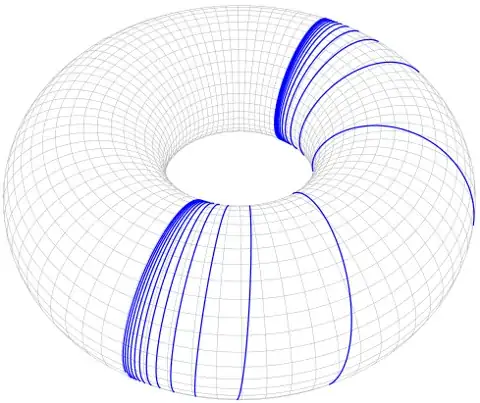

$\newcommand{\Reals}{\mathbf{R}}$Every Riemannian manifold can be isometrically embedded in a sphere; for a Sasaki metric the fibres map to bounded sets, which are therefore not affine.
To flesh out the comment, IIRC, a flat cylinder may be isometrically embedded into a bounded subset of Euclidean four-space by choosing a bounded, complete plane spiral $C$, such as the polar graph $r = 2 + \tanh\theta$, and mapping $S^{1} \times \Reals$ to $S^{1} \times C$ by the identity in the first factor and an arclength parametrization in the second.
Added: I overlooked that the linked question asks about closed (i.e., compact) Riemannian manifolds. The linked answer does not assume closedness, however. For self-containedness: If $(M, g)$ is a Riemannian manifold, there exists an isometric embedding into some Euclidean space $\Reals^{N}$ by the Nash embedding theorem. The real line embeds isometrically in a flat torus $S^{1} \times S^{1}$ (using for example the curve below from the linked post), so $\Reals^{N}$ embeds isometrically in $(S^{1} \times S^{1})^{N} \subset \Reals^{4N}$. Composing gives an isometric embedding of $(M, g)$ in a torus (which incidentally embeds isometrically in a Euclidean sphere).
In particular, a Sasaki metric embeds isometrically into a bounded subset of some Euclidean space, so its fibres do not generally map to affine subsets.
In case it's useful for posterity, these curves can be chosen real-analytically, so the resulted bounded embedding preserves whatever real smoothness is possessed by the Nash embedding.
Embedding the line in a torus, wrapped
