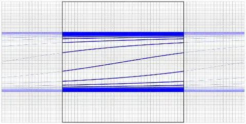

The decomposition $\Reals^{2m} \simeq (\Reals^{2})^{m}$ gives an orthogonal product of $m$ circles of radius $\frac{1}{\sqrt{m}}$ in the unit sphere $S^{2m-1}$. The Euclidean line $\Reals$ can be isometrically embedded into a flat $S^{1} \times S^{1}$ (with circles of equal, arbitrary positive radius $r$). For example, take an arclength parametrization of the path $$ t \mapsto (t, r\arctan t), $$ whose image lies in $\Reals \times (-\frac{1}{2} \pi r, \frac{1}{2} \pi r) \subset \Reals \times \Reals$:
Embedding the line in a torus, unwrapped
Divide by the square lattice $2\pi r\Int \times 2\pi r\Int$ to get an isometric embedding into a square torus. (The square in the preceding diagram is a fundamental domain for the lattice.)
Embedding the line in a torus, wrapped
It follows that Euclidean $\Reals^{n}$ can be isometrically embedded in a $(2n)$-dimensional torus $(S^{1} \times S^{1})^{n}$ whose circles have equal radius, and a "suitably small" torus of this type embeds isometrically into the unit sphere $S^{4n - 1}$.
