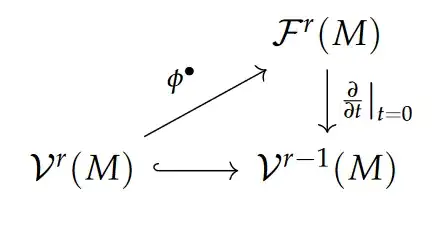

Evaluating the time derivative at $0$ gives a map $\left.\frac{\partial}{\partial t}\right|_{t=0}:\mathcal{F}^r(M)\to \mathcal{V}^{r-1}(M)$:
$$[\phi: \mathbb{R}\times M\to M]\mapsto \left[M\to TM,\,\,x\mapsto \left.\dfrac{\partial\phi}{\partial t}\right|_{t=0}(t,x)\right],$$
and conversely the Existence and Uniqueness Theorem in ODE's says that there is a unique map $\phi^\bullet:\mathcal{V}^r(M)\to \mathcal{F}^r(M)$ such that
$$\left.\dfrac{\partial \phi^X}{\partial t}\right|_{t=0}(t,x)=X(x).$$
(Note that the notation $\phi^X(t,x)=\exp(tX)(x)$ is also in use; compare Why is the domain of the exponential function the Lie algebra and not the Lie group?)

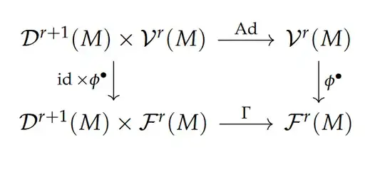

Claim: If $X\in\mathcal{V}^r(M)$ and $f\in\mathcal{D}^{r+1}(M)$, then $\left.\dfrac{\partial}{\partial t}\right|_{t=0}\Gamma_f(\phi^X)=\operatorname{Ad}_f(X)\in\mathcal{V}^r(M)$, or equivalently, $\phi^{\operatorname{Ad}_f(X)}=\Gamma_f(\phi^X)\in\mathcal{F}^r(M)$.
Proof:
\begin{align*} \left.\dfrac{\partial}{\partial t}\right|_{t=0}\Gamma_f(\phi^X)(x) &=\left.\dfrac{\partial}{\partial t}\right|_{t=0}f(\phi^X(t,f^{-1}(x)))\\ &= T_{\phi^X(0,f^{-1}(x))}f \,\,\,\left.\dfrac{\partial\phi^X}{\partial t}\right|_{t=0}(t,f^{-1}(x)))\\ &= T_{f^{-1}(x)}f\,\, X(f^{-1}(x)) =Tf\circ X\circ f^{-1}(x) =\operatorname{Ad}_f(X)(x). \end{align*}
Thus we have a diagram
