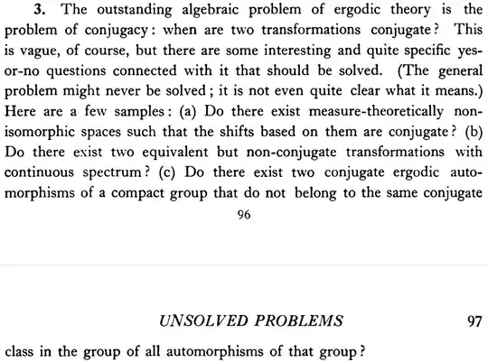

The dynamics perspective on conjugacy is that it's a change of coordinates; see e.g. What is the relationship between the vector fields of conjugate flows?, Topological Invariance of Unique Ergodicity and The Horizontal Flow, The Time-One Map, $C^r$ conjugation and Suspension of a Diffeomorphism for instantiations of this idea. My answer in How a group represents the passage of time? is also relevant. In dynamics and ergodic theory, the problem of conjugacy in fact can be considered to be the major open problem; here is an excerpt from Halmos' Lectures on Ergodic Theory (pp.96-97):

If $M$ and $N$ are two topological spaces and $f:M\to M$ and $g:N\to N$ are two homeomorphisms, call $f$ and $g$ topologically conjugate if there is a homeomorphism $\Phi:M\to N$ such that $g=\Phi\circ f\circ \Phi^{-1}$. (Note that the conjugacies Halmos is considering in the above excerpt are in the category of standard probability spaces.)

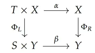

Regarding unification, a categorical language could be a good start. Here is a very rough outline (somewhat in jest) (I'm building on my answer in How a group represents the passage of time?): Let $\mathscr{C}$ be a category that admits binary products (e.g. the category of measurable spaces with measurable maps, or the category of standard measure spaces with measure preserving measurable maps, or the category of metric spaces with continuous maps, or the category of $C^r$ manifolds with $C^r$ maps, or the category of Lie groups and Lie group homomorphisms,...). Denote by $\operatorname{DS}(\mathscr{C})$ the category whose objects are triples $(X,T,\alpha)$, where $X$ and $T$ are objects and $\alpha: T\times X\to X$ is an arrow in $\mathscr{C}$; and whose arrows are pairs of arrows $\Phi=(\Phi_L,\Phi_R): (X,T,\alpha)\to (Y,S,\beta)$ such that $\Phi_R\circ \alpha=\beta\circ \Phi_L$:
Let's call $\operatorname{DS}(\mathscr{C})$ the (nonautonomous) dynamical system object category associated to $\mathscr{C}$. One can consider subcategories of $\operatorname{DS}(\mathscr{C})$ with various further restrictions, e.g.
