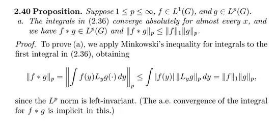

Consider the following fragment from Folland's book "A course in abstract harmonic analysis". Here $G$ is a locally compact Hausdorff group and the $L^p$-spaces are considered w.r.t. a left Haar measure on $G$.
The proof of proposition 2.40 applies Minkowski's integral inequality, however the proofs of Minkowski's integral inequality I know make crucial use of the fact that the measure spaces involved are $\sigma$-finite. However, $G$ with the left Haar measure is $\sigma$-finite if and only if $G$ is $\sigma$-compact, which is not an assumption here.
How can I solve this technicality? Perhaps I can make use of the fact that if $f \in L^1(G)$, then $f$ vanishes outside a $\sigma$-finite set and similarly for $g \in L^p(G)$ with $p < \infty$. Can someone fill in the details? And shouldn't the case $p=\infty$ be dealt with on its own?

    Typically, the group $G$ is assumed to be locally compact Hausdorff so that the Haar measure is indeed a Radon measure. Many important topological groups are $\sigma$-finite w.r.t Haar measure. For more general topological groups, notice that the integrability of $f$ and $g$ (or rather $|f|$ and $|g|^p$, imply that the carriers of $f$ and $g$ (i.e. the sets ${x\in G: |f(x)|>0}$ and ${x\in G: |g(x)|>0}$) are $\sigma$-finite. Thus, the carrier of $(x,y)\mapsto f(y)g(y^{-1}x)$ will also be $\sigma$-finite (w.r.t. the product Haar measure) – Mittens Apr 19 '22 at 14:07
  • @OliverDíaz Thanks! But doesn't this break down if $p=\infty$? – Andromeda Apr 19 '22 at 14:28
  • Folland's book on Abstract Harmonic Analysis, section 2.3: Interlude: Some Technicalities, p.p. 43-46 explains this and some other problems that may arise when dealing with topological groups that are not $\sigma$-compact. This groups contain a subgroup $H$ that is both open and closed and which is $\sigma$-compact. That will help a lot. Finally, notice that for $1\leq p<\infty$, $C_{00}(G)$ is dense in $L_p$; this $L_p$ functions vanish outside a $\sigma$-compact set. – Mittens Apr 19 '22 at 14:28

This is to show that for $1\leq p<\infty$, one can use the generalized Minkowski inequality to easily obtain the integrability of the convolution when $G$ is a locally compact Hausdorff topological group (not necessarily $\sigma$-compact) and integration is done w.r.t. a Haar (left invariant) measure.
Suppose $G$ is not $\sigma$-compact. There is a clopen subgroup $H$ that is $\sigma$-compact, say $H=\bigcup_nK_n$ with $K_n$ compact. Since $|f|,\,|g|^p\in L_1$, the sets $A=\{f\neq0\}=\bigcup_n\{|f|>1/n\}$ and $B=\{g\neq0\}=\bigcup_n\{|g|>1/n\}$ are $\sigma$-finite w.r.t. Haar measure.
Claim I: There are $\sigma$-compact sets $A'$ and $B'$ that contain $A$ and $B$ respectively. Indeed, if $A=\bigcup_nA_n$ with $\lambda(A_n)<\infty$ then, the set $\{x\in G: A\cap (xH)\neq\infty\}$ is at most countable. Then $$A_n=\bigcup_jA\cap(x_jH)=\bigcup_{\ell,j}A\cap(x_jK_\ell)$$ This proves the claim.
Notice that if $f*g(x)=\int f(y)g(y^{-1}x)\,dy\neq0$ then $x\in AB\subset A'B'$ where for any nonempty sets $X, Y\subset G$, $X\cdot Y=\{xy:x\in X,\, y\in Y\}$. The argument above shows that $A\cdot B$ is contained in the $\sigma$-compact set $A'B'$; hence, the domain of integration $G\times G$ can be substituted by $A'\times (A'\cdot B')$, which is $\sigma$-compact and thus, $\sigma$-finite. Then, Fubini-Tonelli's theorem and all the goodness that comes with it holds; in particular, the conditions of the generalized Minkowski inequality are satisfied.

  • Looks good! But I don't think you need to argue using topological arguments (i.e. $\sigma$-compactness). You can just say that $A = {f\ne 0}$ and $B={g \ne 0}$ are $\sigma$-finite (by integrability, you don't need anything for this) and then apply Fubini on $A \times (AB)$. Indeed, Fubini's theorem applies to measurable functions $(x,y)\mapsto h(x,y)$ that vanish outside a rectangle with $\sigma$-finite sides. – Andromeda Apr 22 '22 at 18:58
  • The issue is to prove that $AB$ is indeed $\sigma$-finite. It is true, as I've shown it, but not so obvious. It does require the existence of the coplen subgroup $H$ – Mittens Apr 22 '22 at 18:59
  • Ah I see, good point! – Andromeda Apr 22 '22 at 19:00

Another detail that Folland's proof does not prove is that the convolution $$(f \star g)(x) = \int_G f(y)g(y^{-1}x)dy$$ exists for a.e. $x\in G$, where $f \in L^1(G)$ and $g \in L^p(G)$ ($1 \le p < \infty$).
To see this, first note that $$\int_{G}\left(\int_G |g(y^{-1}x)|^p|f(y)|dy\right)dx = \int_G\left(\int_G |g(y^{-1}x)|^p dx\right) |f(y)|dy = \int_G \|g\|_p^p |f(y)|dy = \|g\|_p^p\|f\|_1 < \infty$$ from which it follows that $$\int_G |g(y^{-1}x)|^p |f(y)|dy <\infty$$ for almost every $x$. But then note that for almost every $x$ we have by Hölder's inequality (applied to the measure $|f(y)|dy$ and the functions $y \mapsto |g(y^{-1}x)|$ and $y \mapsto 1$) that $$\int_G |f(y)||g(y^{-1}x)|dy \le \left(\int_G |g(y^{-1}x)|^p|f(y)|dy\right)^{1/p} \left(\int_G |f(y)|dy\right)^{1/'p}< \infty$$ where $1/p+1/p' = 1$.
