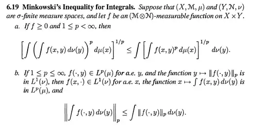

Consider the following theorem from Folland's book "Real analysis: Modern techniques and their applications":
In the book, it can be found on p194 (second edition). I understand the proof of the theorem for part (a) completely. However if $p = \infty$, I don't understand why (b) is true.
In Folland's book, the following is written in the proof:
This is a simple application of the monoticity of the integral.
Can someone explain me why this is true? We have to prove that $$\left\|\int_Y f(-,y) d\nu(y)\right\|_\infty\le \int_Y \|f(-,y)\|_\infty d\nu(y)$$ so for example it suffices to show that $$\left|\int_Y f(x,y)d\nu(y)\right|\le \int_Y \|f(-,y)\|_\infty d\nu(y)$$ for $\mu$-almost every $x \in X$.
Intuitively, we would want to do the following: If $x$ is in some set $A$ with complement contained in a set of measure $0$, then $$\left|\int_Y f(x,y)d\nu(y)\right|\le \int_Y |f(x,y)|d\nu(y) \le \int_Y \|f(-,y)\|_\infty d\nu(y)$$ but to justify the last inequality we need to show that $$\int_Y |f(x,y)|d\nu(y) \le \int_Y \|f(-,y)\|_\infty d\nu(y)$$ for all $x \in A$. However, why is this the case? Am I missing something obvious here?

The case $p=\infty$ follows by a carefully application of Fubini-Tonelli's theorem.
  • Without loss of generality assume $y\mapsto \|f(\cdot,y)\|_\infty$ is finite. Define the set $$B=\{(x,y)\in X\times Y: |f(x,y)|>\|f(\cdot,y)\|_\infty\}$$ This is a measurable set and, by Fubini's theorem, $$\mu\otimes\nu(B)=\int_Y\mu(\{x:|f(x,y)|>\|f(\cdot,y)\|_\infty\})\,\nu(dy)$$ Since $\mu(\{x:|f(x,y)|>\|f(\cdot,y)\|_\infty\})=0$ for all $y$, we conclude that $$|f(x,y)|\leq \|f(\cdot,y)\|_{L_\infty(X,\mu)}\qquad\mu\otimes\nu-\text{a.s.}$$ Hence, for any $A\in\mathcal{M}$, $\mathbb{1}_A(x)|f(x,y)|\leq\mathbb{1}_A(x)\|f(\cdot,y)\|_\infty$ $\,\,\mu\otimes\nu$-a.s.
  • Another application of Fubini's theorem yields $$\begin{align}\int_A\int_Y|f(x,y)|\,\nu(dy)\,\mu(dx)\leq\mu(A)\int_Y\|f(\cdot,y)\|_{L_\infty(X,\mu)}\,\nu(dy)\tag{1}\quad\forall A\in\mathcal{M},\, \mu(A)<\infty\label{one}\end{align}$$
  • If $\mu(A)<\infty$ define $A^b=\{x\in A: \int_Y|f(x,y)|\,\nu(dy)>\int_Y\|f(\cdot,y)\|_{L_\infty(X,\mu)}\,\nu(dy)\}$ ( $b$ stands for "bad"). If $\mu(A_b)>0$ then, by the positivity property of the Lebesgue integral ($\int_X|\phi|\,d\mu=0$ iff $|\phi|=0$ $\mu$-a.s.) we have that $$\int_{A^b}\int_Y|f(x,y)|\,\nu(dy)\,\nu(dx)>\mu(A_b)\int_Y\|f(\cdot,y)\|\,\nu(dy)$$ in contradiction to \eqref{one}; hence $\mu(A^b)=0$.
  • To conclude, let $\{A_n:n\in\mathbb{N}\}$ be an $\mathcal{M}$-partition of $X$ with $0<\mu(A_n)<\infty$. Each $A^b_n$ has $\mu$-measure $0$; hence, for $x\in X\setminus\bigcup_nA^b_n$ one has $$\int_Y|f(x,y)|\,\nu(dy)\leq \int_Y\|f(\cdot,y)\|_{L_\infty(X,\mu)}\,\nu(dy)$$

  • Perhaps a little follow-up question: You say that we may assume that $y \mapsto |f(-,y)|\infty$ is finite. This is because we can define $N = {y \in Y: |f(-,y)|\infty = \infty}$ (which is measurable since $y \mapsto |f(-,y)|\infty$ is a measurable function) and we can replace $f$ by $f\chi{X \times N^c}$. Does this seem correct? – Andromeda Apr 19 '22 at 12:08
    We can assume $y\mapsto|f(\cdot,y)|{L\infty*X)}$ because by assumption it is integrable (w.r.t.) $\nu(dy)$. As you may remember, integrable functions are finite a.e. Sure, you can replace the value of $\infty$ by say, $0$ or any other nonnegative number, ir remove the bad set altogether without changing anything of importance about $(Y,\nu)$. – Mittens Apr 19 '22 at 13:22
