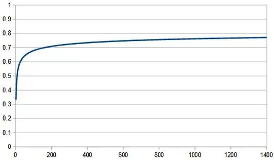

If we wish to compute the probability of returning with finite steps: Letting $f_k$ be the probability of getting the first "return to zero" (first time lights are off) after $2k$ steps (with $f_0=0$), we have the know relationship $$ u_k = f_1 u_{k-1} + f_2 u_{k-2} +\cdots +f_k u_0 \tag 3$$
I've not found an explicit formula for $f_k$. The first values are $$ \begin{array}{[c|c|c]} k & u_k & f_k\\ 1 & 0.333333 & 0.333333 \\ 2 & 0.200000 & 0.088888 \\ 3 & 0.142857 & 0.046561 \\ 4 & 0.111111 & 0.030194 \\ 5 & 0.090909 & 0.021797 \\ \end{array} $$
The convergence is very slow, though, $\sum_{j=1}^k f_k \to 1 - \frac{a}{\log(k)}$ and the probability of having returned to zero after $1400$ steps is still below $0.8$.
