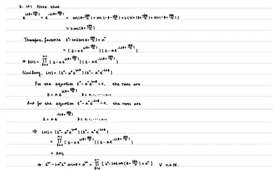

Here is an answer that I have attained eventually. enter image description here
Apply the factorization $$z^n-b^n=\prod_{k=0}^{n-1}(z- b e^{i\frac{2\pi k}n})$$ to \begin{align} z^{2n} - 2 a^n z^n \cos nθ+ a^{2n} =& \left[z^n - \left(a e^{i\theta}\right)^n \right]\left[z^n - \left(a e^{-i\theta}\right)^n \right]\\ =& \prod_{k=0}^{n-1}\left[z- a e^{i(\theta+\frac{2\pi k}n)}\right]\prod_{k=0}^{n-1}\left[z- a e^{-i(\theta+\frac{2\pi k}n)}\right] \\ =& \prod_{k=0}^{n-1}\left[z^2-2az\cos\left(\theta+\frac{2\pi k}{n}\right)+a\right] \end{align}
