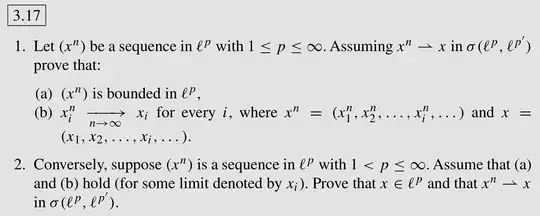

I'm doing Ex 3.17.2 in Brezis's book of Functional Analysis:
Let $E := \ell^p$ with $1 < p \le \infty$. Let $x=(x_{1}, x_{2}, \ldots) \in E$ and $(x^{n})$ with $x^{n}=(x_{1}^{n}, x_{2}^{n}, \ldots)$ be a sequence in $E$. Assume $(x^{n})$ is bounded and $x_{m}^{n} \overset{n \to \infty}{\longrightarrow} x_{m}$ for all $m$. Then $x^{n} \rightharpoonup x$ in $\sigma(E, E')$.
I just want to add a screenshot to make sure that I did not incorrectly quote the exercise.

  • I just want to add this screenshot to make sure that I did not incorrectly quote the exercise. – Analyst Mar 02 '22 at 20:36
    You did. It is $\ell^{p'}$ instead of $(\ell^p)'$. For $p\in (1,\infty)$, this does not make a difference, but for $p=\infty$ you get $\ell^1$ instead of $(\ell^\infty)'$ here. – MaoWao Mar 02 '22 at 20:38
