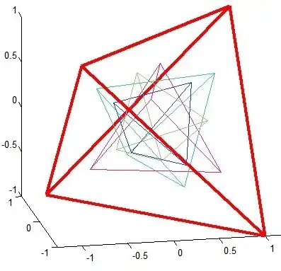

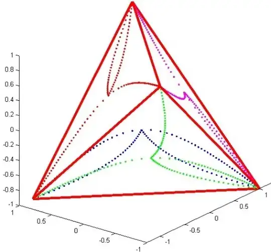

In the case at hand, we obtain almost instantly different solutions. Among them, in blue, we obtain the very particular "central" tetrahedron whose vertices are the centroids of the faces of $(T)$ (this is why we had taken the particular value $z_1=-1/3$...). The two other solutions (in red and green) are spurious, but fulfill all the conditions...
Fig. 1: Results of the program given above.
Fig. 2: With a different value of $z_1$, four different solutions for $T'$.
Fig. 3: The vertices of many different inscribed tetrahedra $(T')$ for many different values of $z_1$, making apparent the fact that they belong to hyperbolic arcs as shown in the answer by @Intelligenci Pauca.
Remark: when a solution $(T')$ has been found (as before, we assimilate a tetrahedron with the matrix $3 \times 4$ of the coordinates of its vertices), we can retrieve

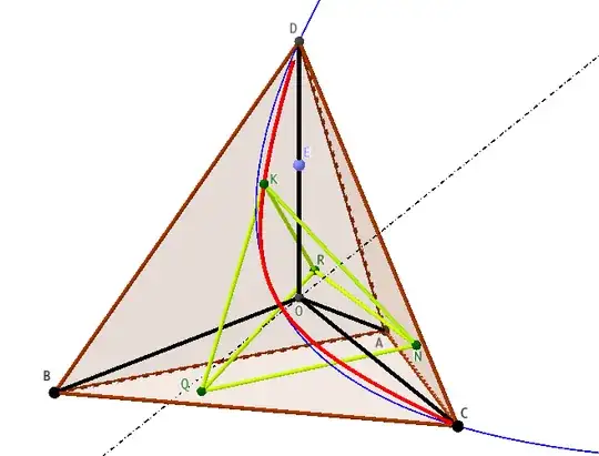

This is not an answer. I just want to show the locus of vertex $K$ (or $N$) of inscribed tetrahedron $KNQR$, obtained by the rotation of a a tetrahedron similar to $ABCD$, with the same centre $O$ and a vertex at $E$, about the line $r$ passing through the midpoints of $AB$ and $CD$.
The locus is the red arc, passing through $C$, $D$ and the centre $G$ of face $BCD$ (not shown). In blue, the parabola through $C$, $D$ with vertex in $G$. Of course the complete locus contains two other arcs, through $BGC$ and through $DGB$.
EDIT.
The locus is of course the intersection between a cone (having $OC$, $OD$ as generatrices) and plane $BCD$, i.e. a hyperbola. That cone is the locus of the circles generated by the rotation of $E$ about $r$, as $E$ varies on $OD$.
In figure below one can see a section of the cone, perpendicular to the intersecting plane $CDG$ ($G$ is the centre of face $BCD$), which is represented by dashed line $GL$. If we take $OC=OD=1$ then $TT'=CD={2\over3}\sqrt6$ and $OG=1/3$.
Points $G$ and $L$ are the vertices of the hyperbola: a little geometry shows that $OL=1$, so that the major axis is $GL=2a={2\over3}\sqrt2=GB$. Hence $L\equiv B$. Moreover, $LL'=TT'={2\over3}\sqrt6$ and $GG'={1\over3}TT'={2\over9}\sqrt6$, hence the secondary axis is given by (see here for details): $$ 2b=\sqrt{LL'\cdot GG'}={2\over3}\sqrt2=2a. $$ This is then a rectangular hyperbola.

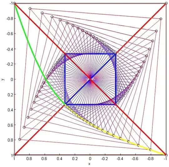

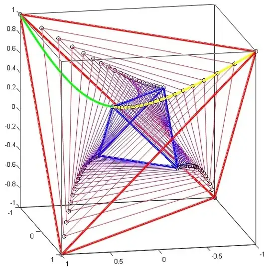

After some hesitations, instead of writing an ever inflating "Edit" to my question, here is a personal answer. Indeed, in the light of the answer by @Intelligenci Pauca, I have realized that this issue should be placed into a different, rather simpler, context.
Let us call $(T)$ the reference regular tetrahedron and $(T')$ its "middle tetrahedron", whose vertices are the centers of the faces of $(T)$.
In fact, the different tetrahedra that can be inscribed into $(T)$ are obtained as "steps" in the four continuous transformations (rotation $R_t$ + shrinking by factor $f$) bringing $(T)$ onto $(T')$, obtained for example with this vertical axis rotation:
$$\underbrace{\left(\begin{array}{rrrr}x_1&x_2&x_3&x_4\\y_1&y_2&y_3&y_4\\z_1&z_2&z_3&z_4\end{array}\right)}_{\text{Tetrahedron} \ T_t}=f_t \ \underbrace{\left(\begin{array}{rrrr}\cos t&-\sin t&0\\ \sin t&\cos t&0\\0&0&1\end{array}\right)}_{\text{Rotation} \ R_t}\underbrace{\left(\begin{array}{rrrr}1&-1&1&-1\\1&1&-1&-1\\1&-1&-1&1\end{array}\right)}_{\text{Tetrahedron T=ABCD}} \tag{1}$$
with $-\frac{\pi}{2} \le t \le \frac{\pi}{2}$ and shrinking factor $f_t=\tfrac{1}{2 \cos(t)+1}$ in the range $1/3 \le f \le 0$ as desired.
Please note that $(T_0)=(T)$ and $(T_{\pi/2})=(T')$.
One verifies that the columns of the first matrix verify resp. the 4 equations of the planes containing the faces of $(T)$:
$$\begin{cases}-x-y-z&=&1\\x-y+z&=&1\\-x+y+z&=&1\\x+y-z&=&1\end{cases}$$
(in the order: faces $BCD, ACD, ABD, ABC$).
The locus of the image of the first column of matrix T gives parametric equations for any branch of one of the hyperbolic arcs described by the vertices, for example the branch pictured in yellow (and green) on the figures:
$$\begin{cases}x&=&\frac{\cos(t)-\sin(t)}{2 \cos(t)+1}\\y&=&\frac{\cos(t)+\sin(t)}{2 \cos(t)+1}\\z&=&\frac{1}{2 \cos(t)+1}\end{cases} \ \ \ \ \text{for} \ \ \ \ -\frac{\pi}{2} \le t \le \frac{\pi}{2}\tag{3}$$
(either we go in one direction, for example following the yellow path, or on the other, the green path)
This branch represents the intersection of a cone and a plane with resp. equations:
$$\begin{cases}x^2+y^2&=&2z^2\\x+y+z&=&1 \end{cases}\tag{4}$$
Fig. 1. $(T)$ in red (inscribed in a cube) and $(T')$ in blue. The locus of one of the vertices of $(T_t)$ (with $0 \le t \le \pi/2$) is represented in yellow (the symmetric curve in green with $-\pi/2 \le t \le 0$ represents another possibility).
Fig. 2 : The same as figure 1 from above.
Much more can be said. If I have time, I will add elements to this answer.

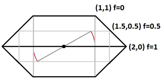

I choose to put the vertices of the outer tetrahedron at $(\pm 2,0,h)$ and $(0,\pm 2,-h)$, where $h=2\sqrt{2}$.
If the inner tetrahedron is scaled by a factor $f$, then its top two vertices will be at height $hf$, so let's look at how the plane $z=hf$ cuts the outer tetrahedron. At $f=0$ it results in the square with vertices $(\pm 1, \pm 1, 0)$, and at $f=1$ it is the degenerate rectangle $(\pm 2, \pm 0, h)$. The tetrahedron edges are straight lines so we can interpolate linearly between these to find the rectangle $(\pm(1+f), \pm(1-f), hf)$.
The top two vertices of the unrotated scaled inner tetrahedron lie at $(\pm 2f, 0, hf)$. If you rotate the inner tetrahedron around the $z$-axis $x=y=0$ until its vertices hit the outer tetrahedron, you can look only in the $z=hf$ plane to see vertex at $(2f,0)$ rotating about $(0,0)$ until it hits a long side of the rectangle at $y=\pm (1-f)$. This obviously means the angle is $\sin^{-1} (\frac{1-f}{2f})$.
Using pythagoras, the coordinate of vertex after rotation is $(\pm\sqrt{3f^2+2f-1}, 1-f, hf)$.
As has already been said, these vertex points for varying $f$ lie on the intersection of a cone, namely $x^2+y^2=(2f)^2=(\frac{2z}{h})^2$, and a plane, the face of the tetrahedron $y=1-f=1-\frac{z}{h}$. Since the plane is at a steeper angle than the cone angle, the vertex points trace out a hyperbola.
