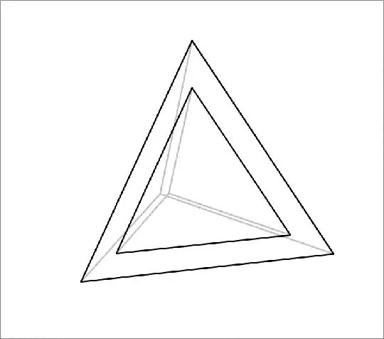

Given a regular tetrahedron, make a uniformly scaled copy of it, such that both the original and the scaled copy (the scale factor is less than $1$) share the same centroid, and have the same orientation. Then rotate the scaled copy such that its four vertices lie on the four faces of the original tetrahedron.
Suppose the scale factor is specified, what would be involved in finding the rotation matrix that when applied to the scaled down tetrahedron gives the desired result of inscribing it in the original tetrahedron?

    Rotate the inner tetrahedron around an axis that goes through the midpoints of opposing edges. By symmetry, its vertices will hit the outer tetrahedron faces simultaneously. This reduces the problem to a 2D rotation of a line segment inside a rectangle. You should get something like $\sin^{-1} \frac{1-f}{2f}$ for the angle I think. Note that there are 6 ways to do this (3 axes to choose from, two directions of rotation). I don't know if there are any other rotations that also work. – Jaap Scherphuis Feb 23 '22 at 09:23

  • I think @JaapScherphuis has solved the problem in his comment above. I have verified that it does indeed result in the scaled/rotated tetrahedron having its four vertices on the four faces of the original tetrahedron. –  Feb 24 '22 at 01:26
  • @DavidG.Stork Check the .GIF animation in my solution below. –  Feb 24 '22 at 01:30

This is not my solution. It is an implementation of the solution outlined by Jaan Scherphuis in his comment above. I've verified the formula he provided and it does work.
Below is an animation that depicts the solution.
