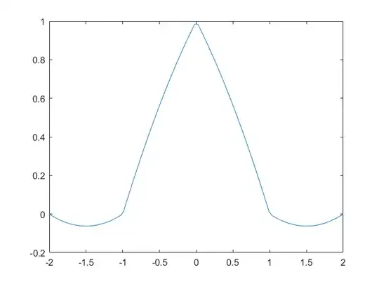

It has the following shape:
Quadratic synthesis function
The $\frac{1}{2}$ version that bubba suggested results in the synthesis function:
$$\phi_2(x) = \begin{cases} -\frac{1}{4}x^2-\frac{3}{4}|x|+1 & |x| \leq 1 \\ \frac{1}{4}x^2-\frac{3}{4}|x|+\frac{1}{2} & 1 \leq |x| \leq 2 \\ 0 & |x| > 2\end{cases}$$
This seems to match quite well what one should expect from Lagrange interpolating functions (I discuss some details here, also using the idea of bubba Constructing $C^{k−2}$ and $C^{k−1}$ splines on a regular grid through convolution). The shape of the synthesis function is:
