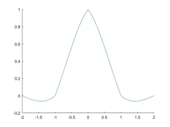

I have derived the interpolating syntehsis function for $\phi_k$ based on Lagrange interpolation. Unfortunately this interpolation is not $C^{k-2}$, I believe it is only $C^0$, although I haven't verified this formally. I have looked at the resulting synthesis functions for a regular grid and those were $C^0$ in multiple examples.

As mentioned the lagrange synthesis functions do not seem to offer higher continuity unlike B-Splines. On the other hand B-Splines require solving a system of linear equations in order to be interpolating along with achieving $C^{k-1}$. The natural question arises whether continuity lower than $C^{k-2}$ can be achieved with interpolating synthesis functions that require only local information (i.e. do not require a solution of a system of linear equations). At least for $k=3$ the answer seems to be yes, as $C^1$ is achieved with the synthesis function from Keys' paper Cubic convolution interpolation for digital image processing:
$$\phi_3(x) = \begin{cases} \frac{3}{2}|x|^3-\frac{5}{2}x^2+1 & |x| \leq 1 \\ -\frac{1}{2}|x|^3 + \frac{5}{2}x^2 - 4|x| + 2 & 1 \leq |x| \leq 2 \\ 0 & |x|>2 \end{cases}$$
Granted this is derived for a regular grid. It does suggest a way of deriving the synthesis functions with the desired constraints not based on Lagrange or Bernstein bases, but directly with desired constraints on the derivatives at different points and so on.
For a comparison I have added two images (the first is cubic Lagrange and the second is cubic Keys ($C^1$)):
Lagrange cubic synthesis function Keys cubic synthesis function
On an unrelated note, funnily the two agree at $\pm 2, \pm \frac{3}{2}, \pm 1, \pm \frac{1}{2}, 0$. The fact that they intersect in the intermediate points makes it so that vertex-centered cubic transfer operators in multigrid could have been derived by sampling either. This is not the case for cell-centered operators however.
