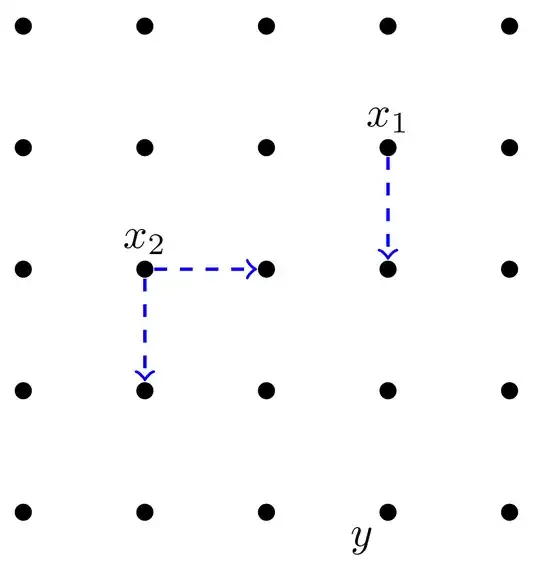

Otherwise, there are either one or two lattice points $n \in \mathbb{Z}^2$ such that
  1. $x$ and $n$ are adjacent
  2. $d_1(n,y) < d_1(x,y)$
We can think of these as "useful neighbors" of $x$ (relative to $y$) – travelling to a useful neighbor gets you closer to $y$, and travelling to a non-useful neighbor gets you farther away from $y$, so we will define $d$ recursively by travelling only to useful neighbors. In the figure below, $x_1$ has only one useful neighbor relative to $y$, while $x_2$ has two useful neighbors relative to $y$.
Illustraition of the idea of useful neighbors.

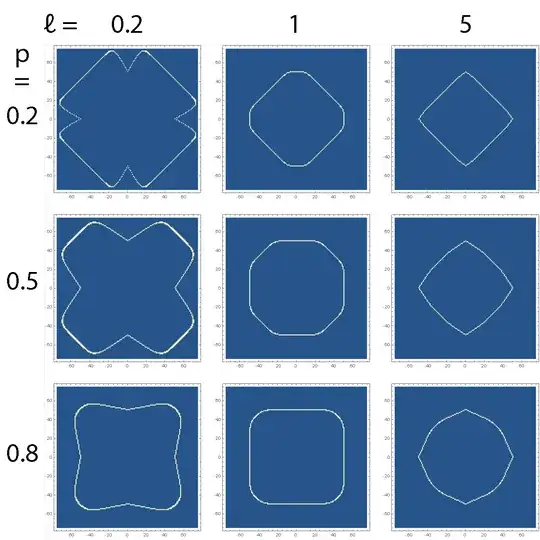

It's horrible to look at, but this gives a complete recursive definition of $d$. I implemented this definition in Mathematica to produce the following visualizations of the balls of radius $50T$ for various values of $\ell$ and $p$:
Images of the balls of radius 50T as ℓ and p vary
Indeed, $p=1/2, \ell=1$ gives an octagon!
  • Fascinating! Especially the questions of strategy in the $\ell < 1$ case; we can see that this strategy is not optimal for near-horizontal and near-vertical directions because an optimal strategy would conform to $d(x,z) \leq d(x,y) + d(y,z)$ and this clearly doesn't. For example in the $\ell = 0.2$ and $p = 0.5$ case, if you are going to the right, it would be better to go up and to the right at about a 30 degree angle for half the distance, and then go down and to the right for the remainder. – Brooks Moses Sep 26 '24 at 08:53
  • What that suggests is that an ideal solution would include the idea that, if all of the "useful" neighbors are blocked, going sideways to a "non-useful" neighboring cell (from which progress may be unblocked) can be worthwhile.
    Even on a 1D grid, this may be worthwhile. In the $\ell=0$, $p=0.4$ case, if you are blocked, the expected time going forward is 1, but the expected time backing up one step (assuming backing up is unblocked) and then going forward twice is $0.4+0.4 = 0.8$. Recursing on backtracking drops that further, and it's an interesting question what the eventual limit is.
    – Brooks Moses Sep 26 '24 at 09:05
  • The $\ell=0.2$, $p=0.2$ case at the top left is one where, in the 1D case, backtracking when blocked forward but not backward is of zero expected value, which suggests that in the 2D case anything that is not strictly backtracking is of positive value. And since the possibility of such options lowers the expected cost of forward progress compared to the 1D case, I think that means in the 2D case the optimal solution is to always move if possible even if it is a pure backtrack, and if multiple directions are possible to take the one that makes the most forward progress. – Brooks Moses Sep 26 '24 at 09:14
