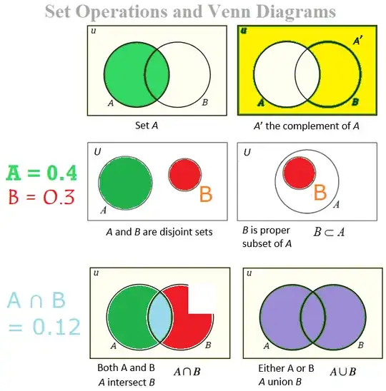

After reading this answer (excerpted above), I drew Venn diagrams below for $P(A \cap B) =0$ (when $A$ and $B$ are disjoint), $P(A \cap B) =0.12,$ and for $P(A \cap B) =0.3$ (when $B \subsetneq A)$.
However, it is $\color{darkorange}{\text{not clear}}$ to me that the only one that would make $A$ and $B$ independent would be $P(A \cap B) = 0.12$. I still can't intuit or visualize independence.

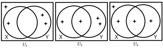

Independence of events is not straightforward to intuit from Venn diagrams (unlike mutual exclusivity, which is observed by inspecting their intersection).
For example: enter image description here
$$\begin{array}{r} \begin{array}{c|c|c} \style{font-family:inherit}{} & \style{font-family:inherit}{U_1} & \style{font-family:inherit}{U_2} & \style{font-family:inherit}{U_3} \\\hline P(X\cap Y) & 0 & \frac14 & \frac14 \\\hline P(X)P(Y) & \frac14\times\frac12=\frac18 & \frac14\times\frac34=\frac38 & \frac12\times\frac12=\frac14 \\\hline \text{$\therefore X$ and $Y$ are$\ldots$} & \textbf{dependent} & \textbf{dependent} & \textbf{independent} \end{array}\hskip-5.5pt \end{array}$$ [Universe $U_1$ above is also an example of the fact that for events with nonzero probabilities, $\big(\text{mutual exclusivity}\implies\text{dependence}\big)$.]

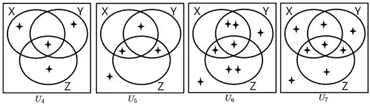

For these multiple-event examples, note that $\big(\,\text{(i) and (ii)}\;\iff\text{(iii)}\,\big)$: enter image description here
$$\begin{array}{r} \begin{array}{c|c|c|c} \style{font-family:inherit}{} & \style{font-family:inherit}{U_4} & \style{font-family:inherit}{U_5} & \style{font-family:inherit}{U_6} & \style{font-family:inherit}{U_7} \\\hline \text{(i) } \mathbf{P(X\cap Y\cap Z)=P(X)P(Y)P(Z)} & \text{no} & \text{no} & \text{yes} & \text{yes} \\\hline \text{(ii) } \text{$X,Y,Z$ are }\textbf{pairwise independent} & \text{yes} & \text{yes} & \text{no} & \text{yes} \\\hline \text{(iii) } \text{$X,Y,Z$ are }\textbf{(mutually) independent} & \text{no} & \text{no} & \text{no} & \text{yes} \end{array}\hskip-5.5pt \end{array}$$
