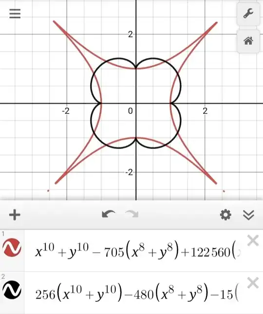

Curves:
epicycloid&hypocycloid
The red curve is the hypocycloid and the other is the epicycloid.
The symmetry of these curves is probably implying that they have well formed equations too.
