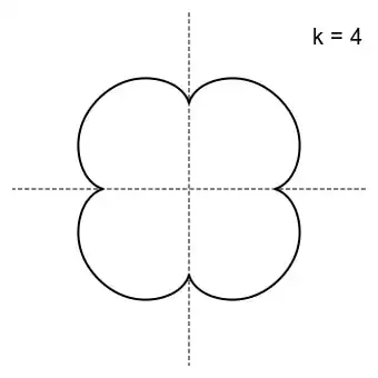

These are the parametric equations of an epicycloid, where the large circle has radius $R=1$, and the smaller exterior rolling circle has radius $r=\frac{1}{4}$.
A possible simplification is writing $$4a=4(x+i y) = 5 z - z^ 5\\ 4b=4(x-i y) = \frac{5}{z} - \frac{1}{z^5}$$ where $z = \cos \theta + i \sin \theta$ and get a relation between $a$, $b$, that implies a relation between $x$ and $y$, see link. Or, we can just give the result provided by WA :
$$-81 - 45 x^2 + 365 x^4 - 15 x^6 - 480 x^8 + 256 x^{10} - 45 y^2 - 2395 x^2 y^2 - 45 x^4 y^2 - 1920 x^6 y^2 + 1280 x^8 y^2 + 365 y^4 - 45 x^2 y^4 - 2880 x^4 y^4 + 2560 x^6 y^4 - 15 y^6 - 1920 x^2 y^6 + 2560 x^4 y^6 - 480 y^8 + 1280 x^2 y^8 + 256 y^{10}=0$$
a curve of degree $10$ epicycloid, <span class=$4$ leaves" />
We can simplify the defining polynomial by writing it as a polynomial in $x^2 + y^2$ and $x^2 y^2$.

    Simplifying by hand I got, $3125(x^2-y^2)^2=[9-4(x^2+y^2)][16(x^2+y^2)^2-3(x^2+y^2)+6]^2.$ According to wolfram alpha, the graph looks like this. Any idea? – ACB Oct 29 '21 at 07:36
