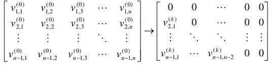

A matrix is formed which contains the coordinates of all the (N-1) elements.
The change of basis here makes the columns of the last two elements equal to zero due to which the said matrix can be embedded in N-2 dimensional space. The transformation can be written as

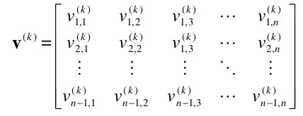

For making the $v^{k}_{r,c}$ equal to 0 we use the matrix given by
Now as you can observe the rotation matrix takes in as input $v^{k-1}_{r,c}$ which is the coordinates after the application of the last rotation matrix. This procedure is repeated until most of the coordinates of the starting plane(the plane we wanted to do rotation about) is zero and then we apply the rotation about this plane. And finally we apply the inverse of the basis change.
My Question - Is there any method in which we do not have to check the coordinates obtained at the intermediate steps, rather we can at the beginning look at the coordinates of the plane and decide the input to all the rotation matrices, to do the basis change and finally the rotation about the subspace.
