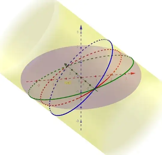

Considering an enveloping cylinder, namely
$$ \left( \frac{x^2}{a^2}+\frac{y^2}{b^2}+\frac{z^2}{c^2}-1 \right) \left( \frac{l^2}{a^2}+\frac{m^2}{b^2}+\frac{n^2}{c^2} \right)= \left( \frac{l x}{a^2}+\frac{m y}{b^2}+\frac{nz}{c^2} \right)^2$$
The eigenvalues $\lambda$ are given by
$$0=\det \begin{pmatrix} \frac{1}{a^2} \left( \frac{m^2}{b^2}+\frac{n^2}{c^2} \right)-\lambda & -\frac{l m}{a^2 b^2} & -\frac{l n}{a^2 c^2} \\ -\frac{m l}{b^2 a^2} & \frac{1}{b^2} \left( \frac{n^2}{c^2}+\frac{l^2}{a^2} \right)-\lambda & -\frac{m n}{b^2 c^2} \\ -\frac{n l}{c^2 a^2} & -\frac{n m}{c^2 b^2} & \frac{1}{c^2} \left( \frac{l^2}{a^2}+\frac{m^2}{b^2} \right)-\lambda \\ \end{pmatrix}$$
where $\lambda=0$ is one of the roots.
The discriminant (with last factor in cyclic permutations of $a$, $b$ and $c$) is given by
$$\Delta =\frac{(l^2+m^2+n^2)^2}{a^8 b^8 c^8} \left( \frac{l^2}{a^2}+\frac{m^2}{b^2}+\frac{n^2}{c^2} \right) [(\alpha l^2-\gamma n^2)^2- 2\beta m^2 (\alpha l^2+\gamma n^2)+ \beta^2 m^4 ]$$
where $\alpha=b^2-c^2$, $\beta=c^2-a^2$, $\gamma=a^2-b^2$.
Note that for $a>b>c>0$,
$$\fbox{$\alpha,-\beta,\gamma>0$}$$
For circular cylinder, there are two equal eigenvalues implying $\Delta=0$, hence
$$\fbox{$\frac{l^2}{n^2}=\frac{\gamma}{\alpha} \land m=0$}$$
The enveloping circular cylinder is given by
$$ \fbox{$\frac{b^2}{a^2 c^2} \left( \frac{x^2}{a^2}+\frac{y^2}{b^2}+\frac{z^2}{c^2}-1 \right)= \left( \sqrt{\frac{a^2-b^2}{a^2-c^2}} \, \frac{x}{a^2} \pm \sqrt{\frac{b^2-c^2}{a^2-c^2}} \, \frac{z}{c^2} \right)^2 $}$$
Further points to be noticed
  • The touching conic is not circular and lying on the plane
$$\color{green}{z=\pm \frac{c^2}{a^2} \sqrt{\frac{a^2-b^2}{b^2-c^2}}\, x}$$
  • The uniform cross section of the cylinder lies on the plane
$$\color{blue}{z=\pm \sqrt{\frac{a^2-b^2}{b^2-c^2}}\, x}$$
  • The circular section for the ellipsoid lies on the plane
$$\color{red}{z=\pm \frac{c}{a} \sqrt{\frac{a^2-b^2}{b^2-c^2}}\, x}$$
