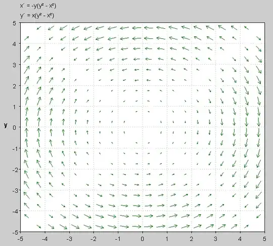

Now, evaluate the eigenvalues of Jacobian matrix of those three critical point (point and two bisectors). What sort of solution do you get when you vary the values for those bisectors?
It looks menacing, but you will that for different $x = y, x = - y$, the Jacobian reveals a phase portrait that is split along those bisectors. For example:
