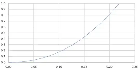

The plot below shows the distribution for $R$, that is $P(R<r)$ with $r$ on the X-axis and $P(R<r)$ on the Y-axis. Here $R$ is viewed as a random variable, as the vertices are random.
My question: My can you compute the maximum for $R$, exactly? Assume, without loss of generality, that the vertices are on the unit circle centered at the origin ($\rho=1$), and that one vertex is $(1,0)$. This eliminates several degrees of freedom. The max value for $R$ is around $0.25$.
