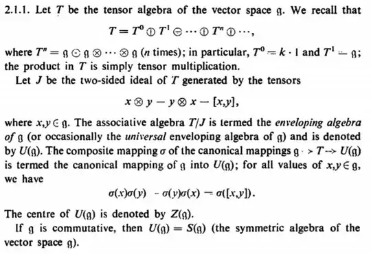

What does the enveloping algebra of $\mathfrak{g}$ have to do with envelopes? If $\mathfrak{g}$ is a Lie algebra, we take tensor algebra on $\mathfrak{g}$ and make quotient through ideal of T, so we put elements of $\mathfrak{g}$ into some equivalence classes determined by the ideal. How is this "enveloping" the $\mathfrak{g}$? What is the intuition?
(Maybe there is no interesting interpretation of this and I am just being too curious, but had to try it).
Remark 1: I am refering to the enveloping algebra of $\mathfrak{g}$, which is sometimes called universal enveloping algebra. It is the same.
Remark 2: I am using the definition from Dixmier:
