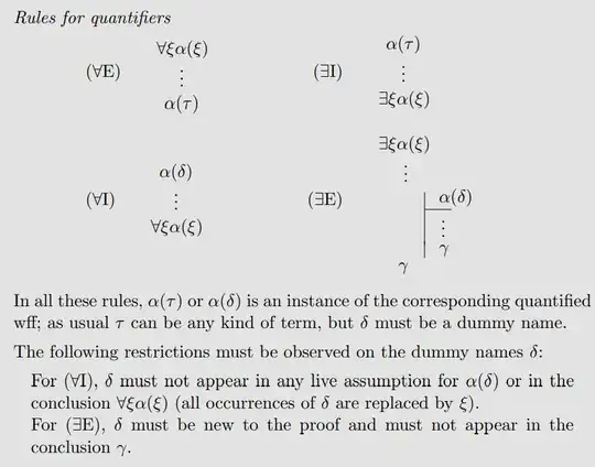

This diagrammatic representation from p. 315 of Peter Smith's book is among the most pleasing & concise that I've seen, although I believe it still doesn't address your requirement for a more symbolical description. enter image description here

  • Yes, I understand these definitions and your existential elimination rule. The problem I am trying to address is I would like to be able to state the elimination rule basically using only metalogical symbols, and not have to require an entire (complicated) English paragraph to explain the restrictions on when the rule can be applied. The motivation for desiring more compact notation to express this idea is that I hope it will make metalogical proofs on the deduction system more easy/clear. – Jagerber48 Aug 05 '21 at 16:39
  • @Jagerber48 I understand, and was going off on a slight tangent. Pertaining to rules of inference, I think that there's a trade-off between accessibility and nuance/detail: I haven't found the particularly lean/pictorial presentations/specifications fully satisfactory, as they tend not to be general enough for my taste. – ryang Aug 05 '21 at 17:38
