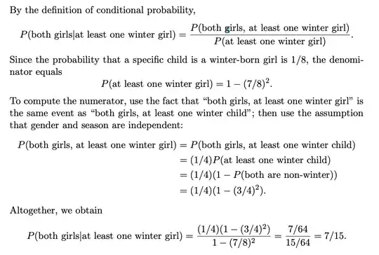

A family has two children. Find the probability that both are girls given that at least one one is a winter-born girl.
I understand all the steps in the solution below except one: "To compute the numerator, use the fact that "both girls, at least one winter girl" is the same event as "both girls, at least one winter child." How does this hold? Doesn't conditioning on knowing that one is a girl make the probability that both are girls higher than the case in which we just condition on season?

"Both girls, one winter girl" means that both children are girls, and out of those two girls, one of them must be a winter girl.
"Both girls, one winter child" means that both children are girls, and out of those two girls, one of them must be a winter child, irrespective of whether that winter child is a boy or a girl.
In the numerator, both children have to be girls, and the winter child is one of those two children, so the winter child must be a girl.
Therefore, the two situations are equivalent.
I hope this explanation helped; if you have any more doubts, feel free to comment on this answer.
This is one of those problems that is susceptible to a simple table of events.
In the table below, the row labels on the left are the possible events for the first child: $G_1$ if a girl, $B_1$ if a boy, $W_1$ born in winter, $P_1$ born in spring, $S_1$ born in summer, $F_1$ born in the fall. The column labels are the possible events for the second child, using the same letters as labels but with the subscript $2.$
Each of the 64 cells of the table under the column labels has (we assume) equal probability, since we assume male and female births equally likely, births in each season equally likely, season and sex are independent, and the births of the two children are independent.
All cells that satisfy "both girls, at least one winter girl" are labeled $A.$ The exact same set of cells satisfy "both girls, at least one winter child": there is no other cell where both children are girls and at least one child was born in the winter. If you doubt this, check all the other cells and see whether any of them is an event in which both children are girls and at least one child was born in the winter.
\begin{array}{c|cccccccc} {} & G_2W_2 & G_2P_2 & G_2S_2 & G_2F_2 & B_2W_2 & B_2P_2 & B_2S_2 & B_2F_2 \\ \hline G_1W_1 & A & A & A & A & C & C & C & C \\ G_1P_1 & A & D & D & D & E & E & E & E \\ G_1S_1 & A & D & D & D & E & E & E & E \\ G_1F_1 & A & D & D & D & E & E & E & E \\ B_1W_1 & C & E & E & E & F & F & F & F \\ B_1P_1 & C & E & E & E & F & F & F & F \\ B_1S_1 & C & E & E & E & F & F & F & F \\ B_1F_1 & C & E & E & E & F & F & F & F \end{array}
If the event $A$ comprises exactly the cells labeled $A,$ event $C$ comprises exactly the cells labeled $C,$ and so forth, we have
\begin{align} A & = \text{both girls, at least one winter girl;} \\ A \cup C & = \text{at least one winter girl;} \\ \end{align}
and by simple counting it is easy to confirm that $P(A) = 7/64$ and $P(A\cup C) = 15/64.$
All the other calculations in the given solution are easily checked as well, although it is not really necessary to make a table to do so. For example, one of the implicit steps in the given solution is
$$ \mathsf P(\text{both girls, at least one winter child}) = \mathsf P(\text{both girls}) \mathsf P(\text{at least one winter child}), $$
which follows directly from the assumption that the seasons of birth are independent of the sexes of the children. (In the next step we substitute $\mathsf P(\text{both girls}) = 1/4,$ and that step is explicitly shown in the solution.)
For comparison, the classic two-girls problem hinges on these events:
\begin{align} A \cup D & = \text{both girls;} \\ A \cup D \cup C \cup E & = \text{at least one girl.} \\ \end{align}
Taking away the "winter" condition allows some additional probability of two girls (cells labeled $D$), but it also allows a lot more additional probability of just one girl (cells labeled $E$).

You are applying Bayes' theorem.
$P(A|B) = \cfrac{P(A \cap B)}{P(B)}$
$A$ is the event of both children being girls and $B$ is the event of at least one of the children being winter girl.
Now if $C$ is the event of at least one of them being winter child, $P(A \cap B) = P(A \cap C)$ as $B \subseteq C$ and $|A \cap (C-B)| = \emptyset$.
You can always find $P(A \cap B)$ directly too.
Probability if both are winter girls: $\cfrac{1}{8^2}$
Probability if exactly one of them is a winter girl and the other is a non-winter girl: $2 \cdot \cfrac{1}{8} \cdot \cfrac{3}{8}$
Adding them up, we have $\cfrac{7}{64}$ which is same as the official solution.
