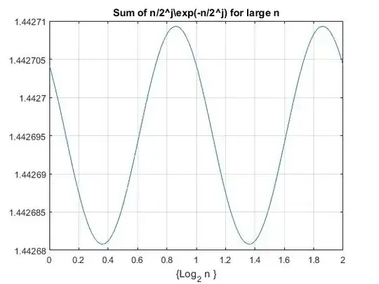

The sum seems to vary at the fifth decimal place. I found a similar result in What's the limit of the series $\log_2(1-x)+x+x^2+x^4+x^8+\cdots$.
As I said above, in comments, the sum seems to be $$\sum_{j=1}^{\infty}\frac n{2^j}\exp\left(-\frac n{2^j}\right)$$ When $n$ is large, the dominant terms are when $2^j$ is close to $n$, then the terms in both directions (both small $j$ and large $j$) approach zero. So the sum becomes $$\sum_{k=-\infty}^{\infty} 2^{k+\log_2 n}\exp\left(-2^{k+\log_2 n}\right)$$ and the sum is the function of the fractional part of $\log_2 n$.
The graph below shows this sum varies at the fifth decimal place - the amplitude is around $0.00001426$. This is not an artifact. I took $k+\log_2n$ ranged between $-30$ and $30$. The missing terms for $k+\ln n\lt-30$ are $O(2^{-30})$, and for $k+\ln n\gt30$ are $O(\exp(-2^{30}))$.
