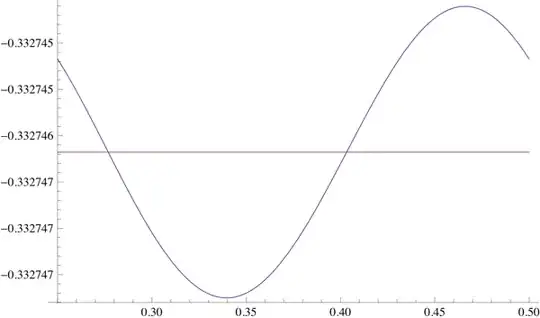

The function given in $(4)$ for $x=2^{-2^{-t}}$ has period $1$ in $t$. I have computed $f(1)$ from $(4)$ for $x\in\left[\frac14,\frac12\right]$; that is, the full period $t\in[-1,0]$. I get a plot very similar to that of Michael:
which oscillates between $-0.33274775$ and $-0.33274460$. The horizontal line is $$ \frac12-\frac\gamma{\log(2)}=-0.33274618 $$ which is pretty close to the average of the minimum and maximum.
I am still looking for an a priori method to compute this oscillation.

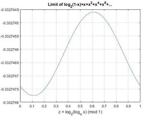

$$f(x)+\log_2(1+x)-x=f(x^2)\text{ ( 0<x<1 )}\\ f(exp(y))+\log_2(1+\exp(y))-\exp(y)=f(\exp(2y))\text{ $(-\infty<y<0)$}\\ g(y)+\log_2(1+\exp(y))-\exp(y)=g(2y)\text{ $(-\infty<y<0)$}\\ g(-2^z)+\log_2(1+\exp(-2^z))-\exp(-2^z)=g(-2^{z+1})\text{( $-\infty<z<\infty$)}\\ h(z)+\log_2(1+\exp(-2^z))-\exp(-2^z)=h(z+1)\text{$(-\infty<z<\infty)$}\\ f(1)-f(0)=\int_{-\infty}^{\infty}dh=\int_{-\infty}^\infty\log_2(1+\exp(-2^z))-\exp(-2^z)dz\\ \approx -0.332746$$ By change of variable, it becomes $$\int_0^1 \frac{x-\log_2(1+x)}{x\log x\log 2}dx$$ which the Inverse Symbolic Calculator gives as $$\frac12-\frac\gamma{\ln2}\approx -0.3327461772769$$ As pointed out by Somos, I took an approximation when I replaced $\sum h(z+1)-h(z)$ by $\int dh$. It seems to have variation in the sixth decimal place as $x$ varies from $x_0$ to $x_0^2$.
Empy2
  • 52,372
Let $\ f(x) := \log_2(1-x) + \sum_{n=0}^\infty x^{2^n}, \ $ $\ g(x) := f(e^{-x}) = \log_2(1-e^{-x}) + \sum_{n=0}^\infty e^{-x2^n}, \ $ and $\ a_k := g(2^{-k}) = b_k + \sum_{n=0}^\infty e^{-2^{n-k}} \ $ where $\ b_k := \log_2(1-e^{-2^{-k}}) \approx -k - 2^{-1-k}/\log(2). \ $ Now $\ \sum_{n=0}^\infty e^{-2^{n-k}} = \sum_{n=1}^k e^{-2^{-n}} + B \ $ where $\ B := \sum_{n=0}^\infty e^{-2^n} \approx 0.521865938459879089046726. \ $ But $ c_k :=\! -k \!+\! \sum_{n=1}^k e^{-2^{-n}}\! = \sum_{n=1}^k \big(e^{-2^{-n}}\!-\!1 \big) \ $ and $\ c_k \to C \ $ where $\ C \approx -0.8546133208927. \ $ Finally, $\ \lim_{x\to 1^-} f(x) = \lim_{x\to 0^+} g(x) = \lim_{k\to\infty} a_k = B+C \approx -0.3327473824328992250.\ $ The digits of $1$ minus this number is OEIS sequence A158468. $f(\exp(-2^{-30})) \approx -0.3327473822.$
EDIT: Unfortunately, it seems that the function $\ f(x) \ $ oscillates as it gets close to $1$ from below. That is, $\ g(2^{-x}) \ $ approaches a period $1$ function with mean value $\ 1/2 - \gamma/\log(2) \ $ with oscillations of magnitude $\ \approx 1.57315\times 10^{-6} \ $ as Michael shows. Thus, the limit does not exist. It was obvious that the infinite sum in $\ f(x) \ $ has radius of convergence $1.$ What was not obvious was the limiting behavior as $\ x\to 1^-. \ $ We now know that the series has a logarithmic singularity and $\ f(x) \ $ is what remains. That $\ f(x) \ $ has interesting oscillatory behavior is nice information.
