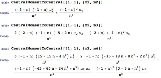

  • Second Row:
where $\mu_i$ denotes the $i$th central moment of the population of $X$.

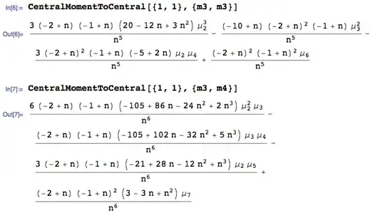

  • Third Row:

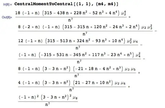

  • Fourth Row:
All other results by symmetry.
